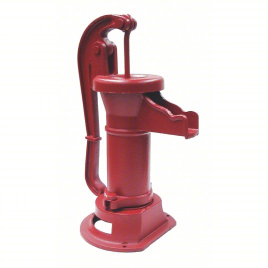

If you bury a ribbed water tank below your frost level, and use a 12V pump and hoses to fill it from the well, that would work. I have seen those red arm pumps that were used on farms work well to get the water up, mounted at the kitchen sink, you have to prime it first to get a good suction going. They still make them new. Has a valve to drain it back down so it doesn't freeze.
Thought of burring a tank. Just keep it clean with a little bleach? Also, the farm pump or hydrant is a good idea. Yes, that 'navy' shower, is really the way to go with limited water supply!

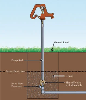

A small section that's exposed could be insulated and put heat tape on it. If leaving it should be drained though. You can use a curb stop valve to have a valve below frost line or you can use a frost free yard hydrant.

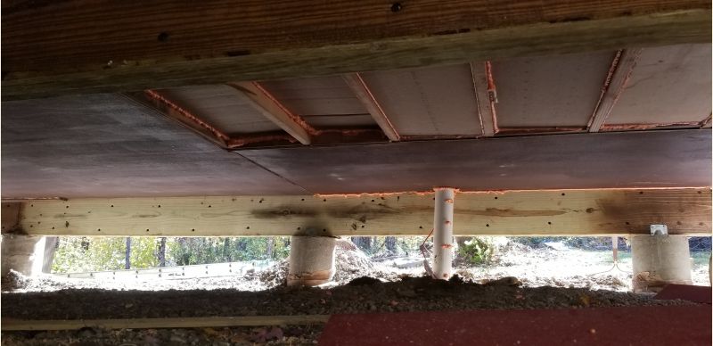

I have a drywell line that I recently buried. We have a cabin in central NY with no skirting and no plan to skirt, we have 4in foam in the floor. My drywell uses 1.5in pvc with heat tape around that 4in pvc around it all. I then used caned spray foam to fill up the void between the 1.5in and 4in pvc. The heat tape is just Incase it ever freezes.
You can see it here with orange foam coming out of it. It also shows the layout of my Insulated floor with no skirting. 4in of foam is way warmer than the ground in winter, it's also dryer and dosnt hold mold.

The hydrant has the water spigot by the handle, above the ground, how do you continue the water line from the spigot into the cabin? Insulate that part too?
In your photo it looks like you've insulated the plumbing right from your buried water line up into the cabin.
In that scenario, the water comes down from the well, gravity feed, into cabin (maybe with a pump if pressure is not enough) and the last distance the water travels up from the ground to the cabin via insulated pipe with heat tape run by solar. That makes sense, I like that.
