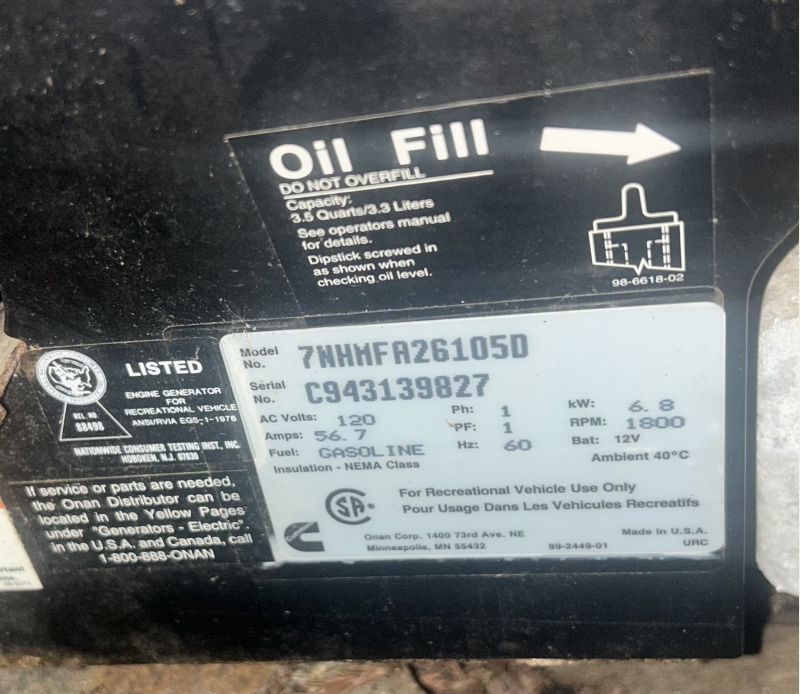

Yeah I’m thinking about cabling mine to the battery bank, now that I know it needs charging. Problem might be if the bank dies, no genny startup.
Other thing, if you look at my Onan tag, it says fuel - gasoline. When I got it I’m sure it was set up for LP. That’s all I’ve ever run it on.
