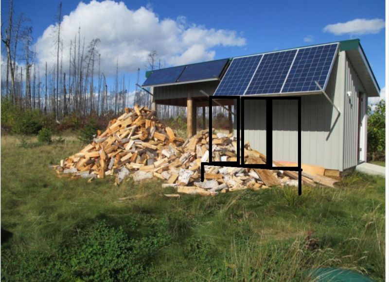

My initial thoughts.
Move the closest wood pile.
Sink 2 galvanized fence posts into the ground (auger and cement).
Use a galvanized pole between the 2. (horizontal)
Attach the new panels from that pole up to the old panels. (Cheap and VERY secure).
I have attached a VERY crude drawing to make it a little clearer. Of course the angles aren't right as I'm a terrible artist.
