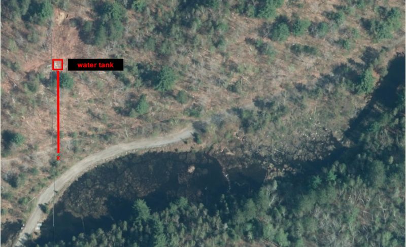

Has anyone dug a well next to a creek? From my preliminary digging findings, there is an area next to the creek which is about 4' deep composed of gravel and sand. Underneath it is bedrock. Is it worth digging a well in this area or is it likely the water will be contaminated? This is marked by the "X" in the image below.

Depends on what you are using the water for and whether it is going to be filtered/treated, as well as what is upstream. And how much demand you have. I use surface water from a small creek that I have had tested for contaminants. Upstream there is nothing that might cause problems. I also filter the water through a ceramic filter for household use. Has worked fine for 10+ years. You might consider driving a sand point, depending on the nature of the creek - might be easier than digging a well.
# Posted: 24 Feb 2025 11:26pm
If you expect to drink it straight out of the ground..I wouldnt. UV systems are prety cheap.

Looks to me more like a pond than a creek. Is that right? Like brettny said, it's best to treat/filter it if you're going to drink it. You could dig it and test it, too, see what's in it, if anything, then figure out what to do from there.....

In my experience living on a creek you don't want to use creek water for one simple reason, you have no idea what got put in or died upstream. Typically you want a relatively deep well so it has perked through layers of dirt and stone which typically filter out impurities.
