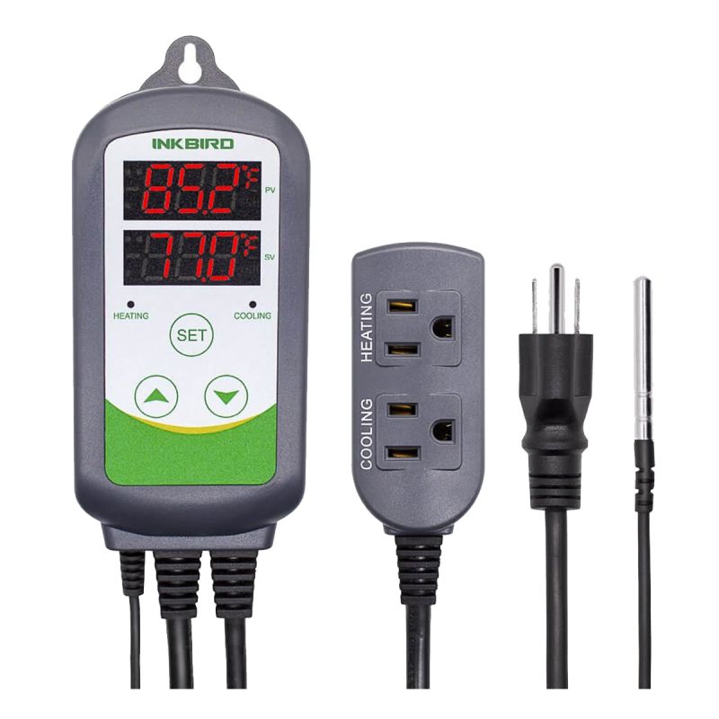

If you do decide to move ahead, the best way to control a freezer (that I know of) is to use an Inkbird temp controller. Plug the Inkbird in the wall, the freezer into the Inkbird and the Inkbird temp probe in the freezer. This allows the controller to turn the freezer on and off as needed to hold the temperature you want. You can set a delay to protect the compressor and on/off temperature range. Best part is they are only about $35.

Purchased the Ink Bird temp controller. Used it in conjunction with my Jackery for the men time. Works like a champ! Printed directions are not the greatest. But, thanks to YouTube all is well.

That suggestion for the ink bird was a lotto winner. Thanks

We run a stand up freezer as a fridge using an Inkbird. Nowadays you can simply buy a freezer at Costco that is capable of fridge temps. Both stand-up or chest.

Do these not have thermostats? What do the inkbirds do different?

Up until a couple of years ago all freezers had thermostats that didn't adjust to a temperature warm enough to be used as a fridge. The warmest you could adjust them was like -7C.
For those freezers if you want to use them as a fridge you needed to install an inkbird to replace the internal thermostat.
Some manufacturers caught on that some people want to use them as fridges and started putting wider thermostats in them recently.

Also, often times freezers have a several degree temperature differential..... between coming on and going off. Their whole function is to keep food frozen. The Inkbird allows you to set that differential to keep a more constant temperature.
A side note.... I found in my beer kegerator that I can keep an even - contents - temperature by inserting the Inkbird probe in a gallon of water. This way it is monitoring the temperature of the contents not the air temperature.

I usually set 3 degrees differential and there is the ability add a delay between off/on so you don't try to cycle the compressor that Jay still be under pressure.
It would seem it could have more energy usage but my experience is no, it doesn't. But, again I keep my temp probe in a gallon of water, this way you aren't measuring air temperature but rather the temperature of the items you are trying to keep cool. I know my kegerator does not cycle on and off too many times a day.

Ok well the proof is in the pudding. Obviously they don't have to run as long. How do you add the sensor?
# Posted: 31 Mar 2025 09:43am
There is a "sensor" with about 3' of wire coming off the control head.
# Posted: 31 Mar 2025 10:25am
Looks Like 'plug & play'
