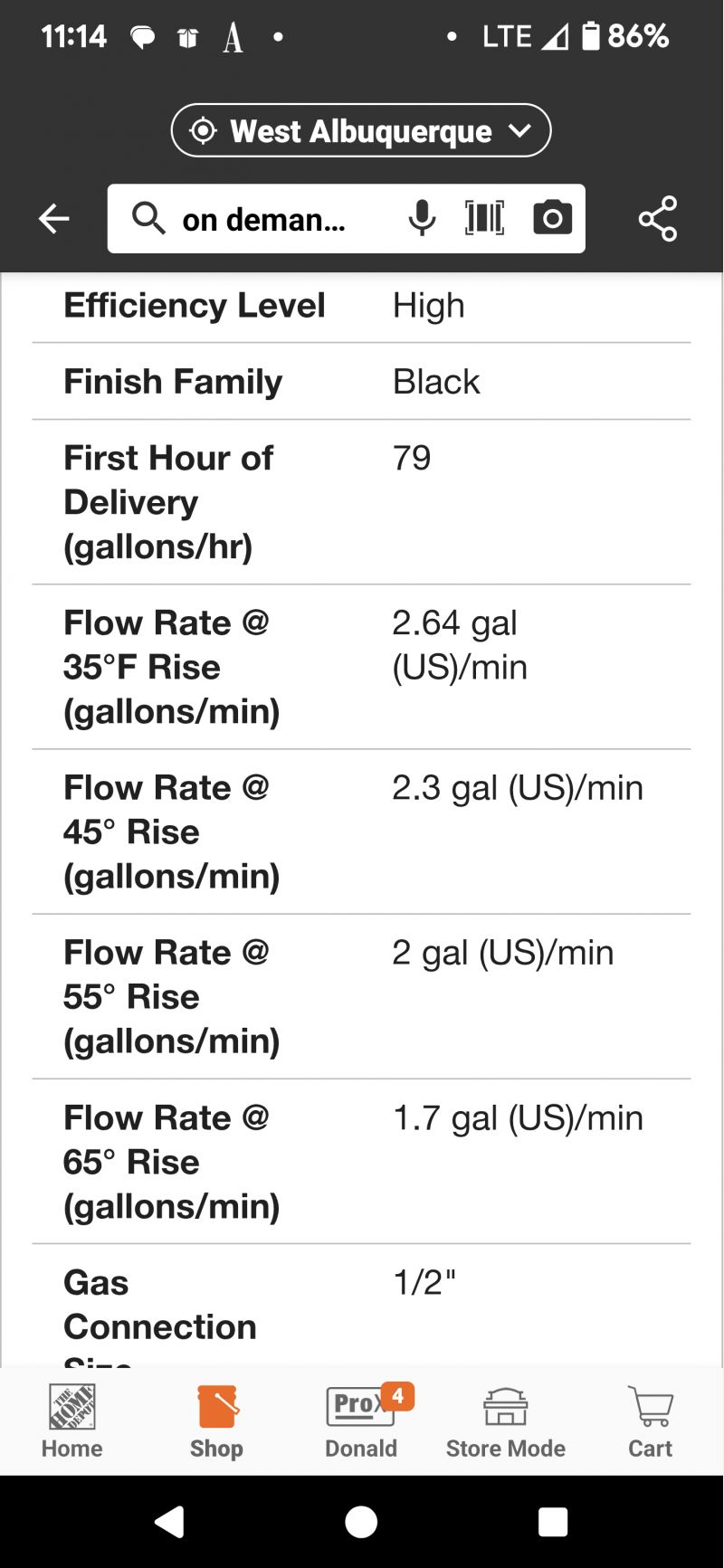

I don't see any specs on the degrees of temperature rise at different flow rates. I would like to know that as the listed flow rate could not be viable if the heater cannot raise the water temp ehough.
Here's a screenshot from the specs on a $300 68,000 BTU heater @ HomeDepot as an example of a flow rate, temp rise chart
Flow, rise
Flow, rise

# Posted: 22 Mar 2025 02:40pm
MtnDon do you have the model number?

# Posted: 22 Mar 2025 03:25pm
Home Depot
Camplux
Look under specification
Internet # 317138971
Model # CM264B-N1
UPC Code # 630792537943
Store SKU # 1006585767
User manuals, etc are downloadable
I just used that as it was the first similar sized that had the temp rise @gpm listed.

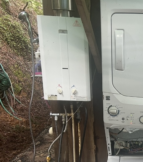

I personally went against all safety rules and installed my eccotemp inside. Yeah I know the safety people are going to panic.
But, in 10 years of use, even with 5 guys at deer camp showering back to back in an enclosed bathroom, there is no issue. If you navy shower the amount of run time is minimal. I burn more propane on my stove cooking dinner. There is more moisture introduced from the shower water than from burning of propane.
I'm sure if you tried to fill a bath tub it could be an issue, but for a quick shower or warm hand wash its not. I had industrial grade air monitors when I first installed it and never registered any CO during or after a shower.
Obviously you need to use your head, but it can be done safely. I get measurable levels of CO when I use my propane oven, or propane lights, but never with my water heater, but it just doesn't run for long.

My Ecotemp is plumbed direct to an outdoor shower that we use 99% of the time, works great. It also connects to the indoor shower and sink that use standard hot cold mixing valves. The minute you try to add cold it shuts off the hot. And being outside, no adjusting the Ecotemp knob while showering.. Wish it was inside like FishHog just said but not enough to bother messing with it now.

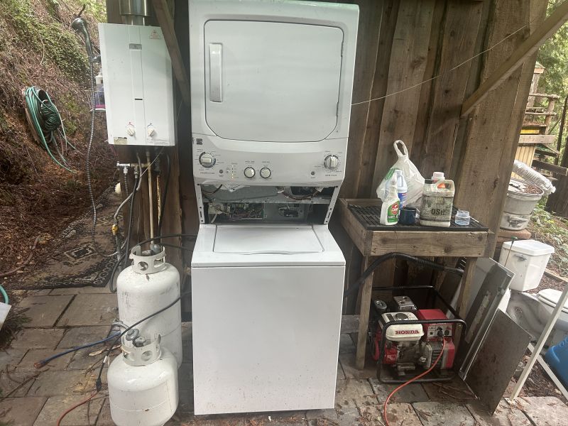

# Posted: 25 Mar 2025 03:32am
@paulz....is that a washing machine in that picture?
# Posted: 25 Mar 2025 10:27am
Quoting: rachelsdad
Yep, washer and dryer combo a friend gave me this summer. I do all the laundry here now, free water and electricity, and we’re here more often anyway. I don’t use the dryer much, just hang overnight by the wood stove.
