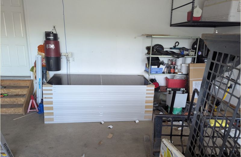

I purchased a couple of panels for our cabin about 2 years ago from a local "one man company". On the weekend he reached out and said he was liquidating his current stock and would I want any panels. He offered me the same panel I bought for my cabin (Jinko 540W bifacials) for $140CND.. Not kidding...
Dammit, I didn't need anymore projects. But I guess our new house is going solar.
P.S. Those panels have been performing WAY beyond my expectations for the last 2 years!

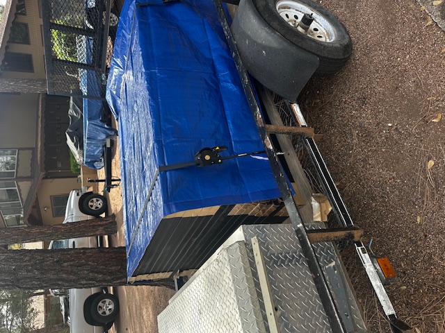

BTW.... I just scored 19 brand new Trina 255w smart panels from a guy near us... he even delivered them... for $37 each! The crazy thing is I only ordered 15 from him but he had a broken pallet with 19 on it so gave me all 19 for the price of 15!
He and a partner bought out a bankrupt solar company warehouse. He still has 100 pallets of the 255w, 20 pallets of 325w and all the goodies that connect to the smart panels for monitoring and rapid shutdown... as well as a stack of Sunnyboy grid tied inverters. He is selling a complete 10kw grid tie system, minus the mounts and wiring for $2,395.
I can hardly resist! But like you travellerw... I don't need another project!
