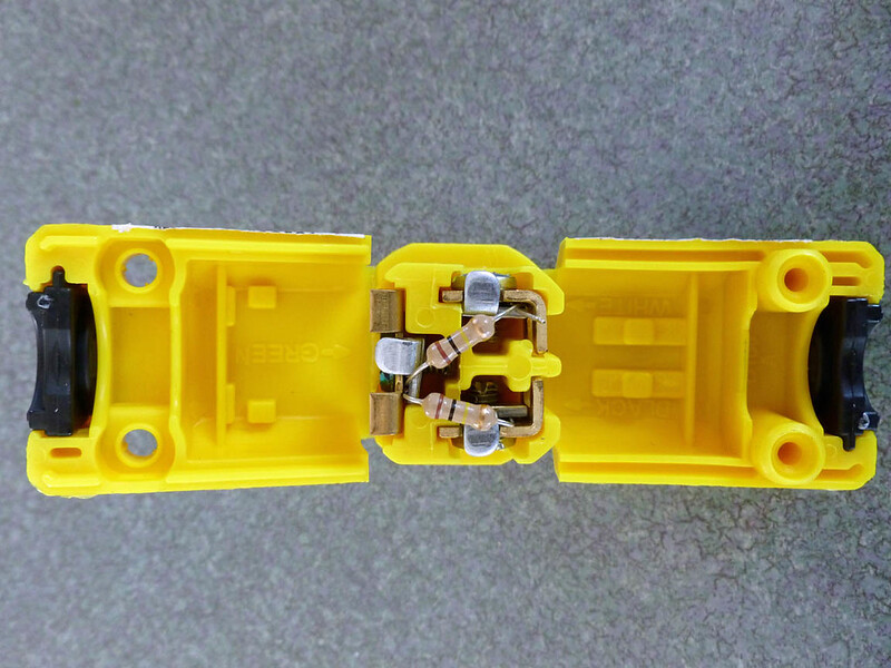

gcrank1: The blown fets are due to the bad firmware over voltage settings, normally I would have max charge rate at 14.6 as recommended but have turned it down to 13.7 as a precaution to see how it goes.
ICC, Yes I am charging via Grounding Plug, Battery, Inverter, Car at 120 volts @ 13 amps lvl 1 but neither Leaf will accept it yet it works with my Inverter generators no problem.
travellerw, The Grounding plug goes into the outlet of your generator, it fools the car into thinking it is grounded, is made using a Nema 5-15P Plug and two 100EPS12100K 100K ohm resistors 1/2 W, 5% can be gotten on Amazon super cheap. Here is a photo of the plug.

# Posted: 6 Jun 2025 11:34pm
Is it a quality Pure Sine Wave inverter?
Cool to know there is a workaround. One of the generators we have has a copper lug on the front that is wired directly to the ground pin. Its a Chinese unit and the picture instructions show clipping a wire with a nail to that lug, then sticking the nail in the ground. I planed to try that unit on the Tesla to see if it "accepted" that ground.
