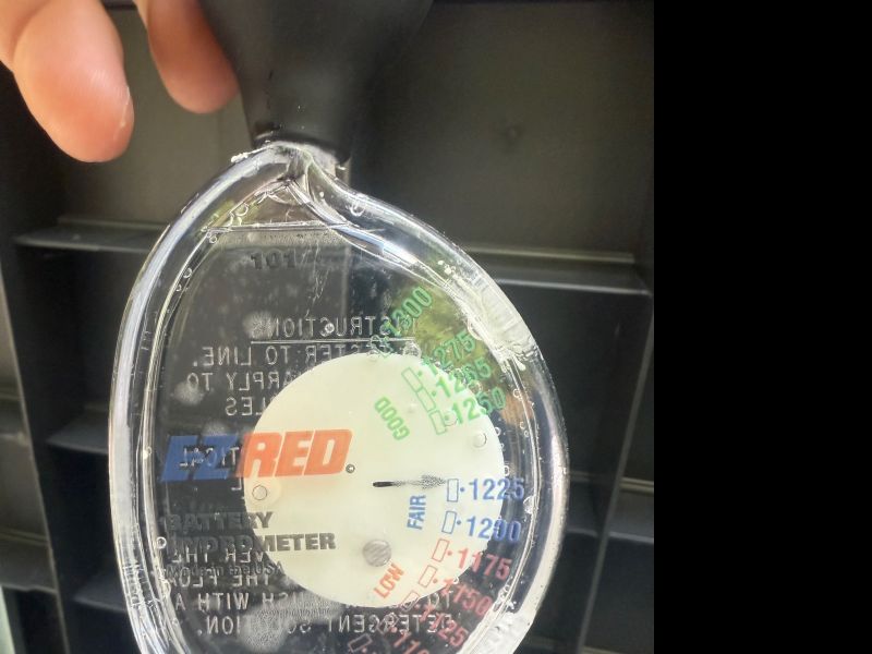

Just checked all 24 cells
22 cells read around 1150 - 1175 max
2 cells read as shown below, around 1225

# Posted: 19 Jun 2025 11:09pm
Your bat-bank is only as good as its worst battery, it will drag the rest down.
You must number the bats, and number the cells in each and test/record ALL that so you can determine which is the culprit.
As far as killing them....Lead Acid bats have just only so many charge/discharge cycles, faarrr less than LFP.
GC bats are made more heavy duty than marine/rv bats and can take more deep discharges BUT if you regularly discharge to, or below, 50% you kill them much faster; LFP NO Prob.
My target with LA was 30% discharge for long life and only below that to max 50% if necessary. Then on a good solar day to be recharged full by 1pm.

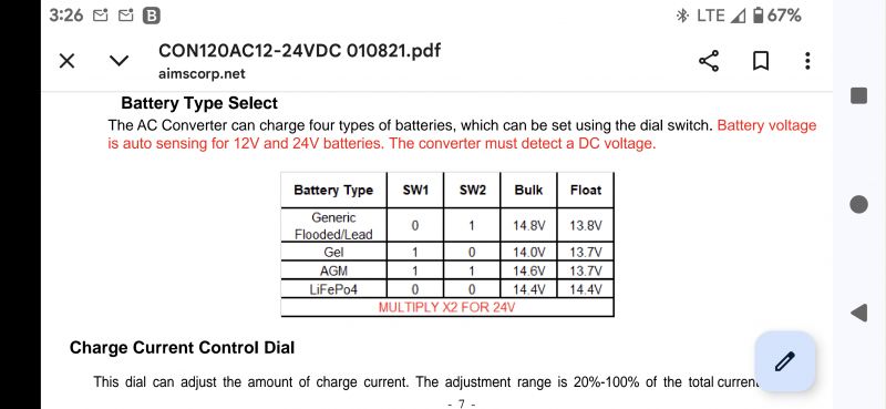

I would highly doubt your current battery charger would work with lithium batteries unless the voltage is selectable. If your going to swap out the inverter too just get a inverter charger. Most will have some type of transfer switch built in too.

I had a quick look at the user manual for the AUMS charger. It's LFP setting has fixed voltages: both bulk and float at 28.8. That's not going to be the best for battery life. For example SOK recommends 27.6 volts for float on 24 VDC battery. (13.8 on 12 VDC)
You should the solar charge controller too. For best LFP life any charger should allow the charge/float voltages to be custom set to tenths of a volt.
Most good LFP should also have a bluetooth app
Also, some chargers are too 'smart'. Some will not charge a battery unless they first sense a voltage. The BMS in many LFP batteries basically shut down after a period of no charging or discharging. This is to prevent the battery being discharged from the power the BMS uses when it is sitting idle, but waiting for something to happen. Think of this like the standby loss of an idle inverter.
There are good quality chargers (AC & solar) that will work on a LFP battery with a sleeping BMS. And there are ways to trick the battery BMS to wake up. Partly depends on how easy, how plug'n'play you want this to be.

Screenshot from AIMS manual
AIMS
AIMS
