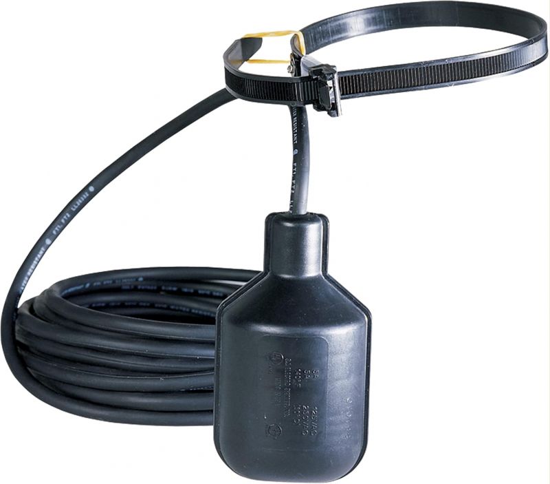

# Posted: 8 Jul 2025 07:59am
Man, this is so easy.
Tether float switch from a septic surge tank or tank alarm.
Home Depot, Lowes, Amazon...
Tether Float Switch
