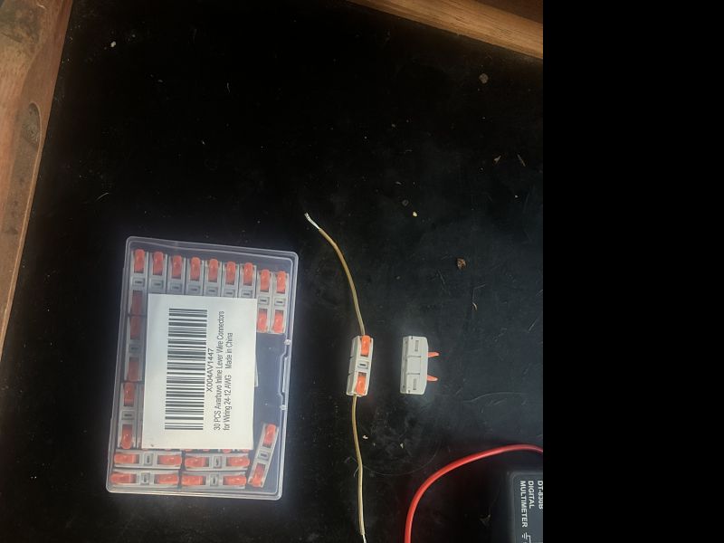

# Posted: 19 Jul 2025 09:18am
Quoting: travellerw
Those are great for hobby stuff (or things like 12V in an RV, speaker wire, ect ect). I use those for tons of stuff
Ordered, thanks! My cabin is still mainly 12v (water pump, TV, fridge) and usb for lights and phone chargers.

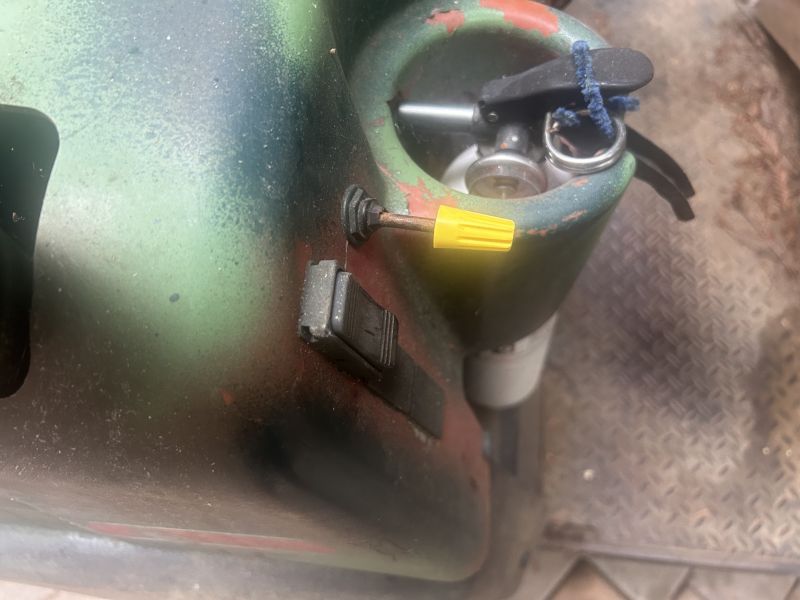

# Posted: 24 Jul 2025 07:08pm
Speaking of wire nuts, I bought a snowmobile from a retired electrician. I found wire nuts under the hood fixing some mouse-damaged wires, and even one serving as a splice for a failed choke cable!
# Posted: 25 Jul 2025 07:33am
Quoting: rpe
Bush fix that worked so was just forgotten about. Or knew he was selling so didn’t care

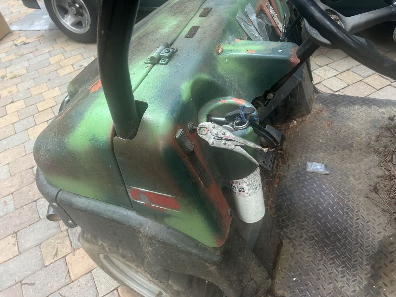

# Posted: 25 Jul 2025 10:36am
Good idea! Tired of wasting these vise grips. Choke knob broke off long ago.

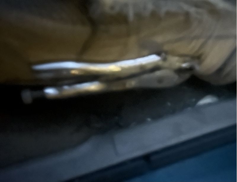

# Posted: 26 Jul 2025 08:53am - Edited by: paulz
Quoting: rpe
Sorry to de-rail the wire-nut conversation!
No problem, we can always enjoy a little bush humor, can’t all be perfect. Here’s the seat back adjuster in my 30 year old last legs pickup. Again, plastic lever broke years ago (gee, maybe it’s me). I’ll weld something on if I get it near a mig, the splines are long gone, but it is handy always having vice grips at a known location. What did we ever do before they came along.

Got em yesterday. Tested on speaker wire, held great. Says goes up to 12 AWG, sounds like a lot.
# Posted: 6 Aug 2025 03:34pm - Edited by: MtnDon
Those look like WAGO clones? Copies that look like WAGO, but do not have the WAGO logo imprint?
This is sorta like the topic on Simpson screws; these look more or less like the real thing but may have deficiencies. No UL listing most likely.
From what I see in reviews of the WAGO clones, there are some reviewers who have tried them and concluded that they would not trust them to be used with household circuits of 120 VAC. They didn't hold the solid wires they tried as solidly as the real WAGO. ; They used wires like romex 14 or 12 gauge. Low voltage wires for LEDs, thermostats and the like, maybe?
