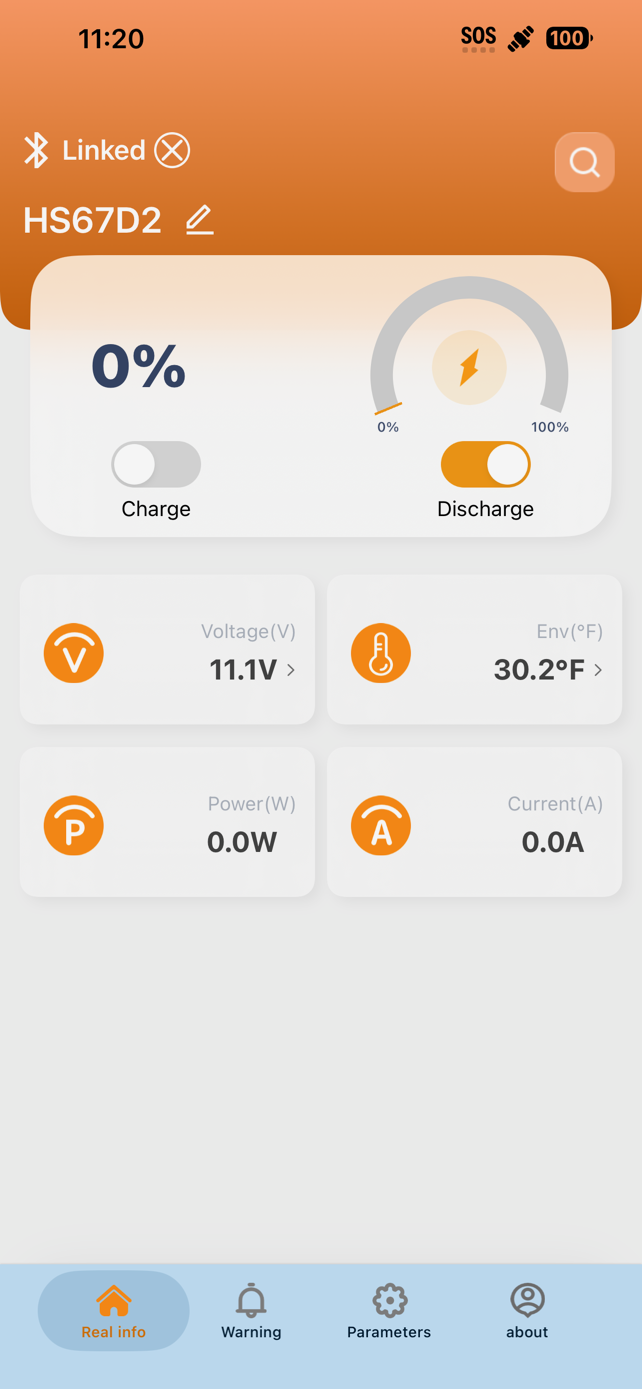

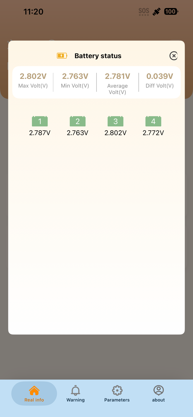

# Posted: 29 Mar 2026 01:07pm
Made it up several times this winter and had good success with the new battery. However, on one trip in mid February I arrived to a dead battery. With sub-zero temps, battery heater left on, cloudy days and snow covered solar panels it was expected I guess. So I brought it into the cabin from the power shed to warm up before reconnecting it, fired up the generator and charger... Good as new!
# Posted: 30 Mar 2026 08:25am
The BMS did a very good job of cutting off at 2.8 Volts per cell. That is "proper" protection because it did not bottom the cells. THAT IS REASSURING ! The fact that the cells were very close together with only 0.039V differential shows they used quality matched cells within.

Re above post: so when I got back to the cabin Monday, both Humsienks were dead. They both read half a volt, unhooked. A bit surprised as I thought the BMS would have shut them off sooner. Good news is they both charged right up to 13v. Still haven’t figured out what happened, must have left something else draining them, but they both passed the car headlamp test afterward.
So they are going back in storage. I read best Lfp storage voltage is 3.2-3.4 per cell, pretty wide. I want them at the ready if needed so wil go for the high end.
# Posted: 3 Apr 2026 11:20pm
1/2 V means the BMS set discharge to Off. Of course the moment you put the charger on it started accepting juice as charge was set to On. That's exactly how a BMS should behave. Had there been 0.0V then the cells would have been depleted & the BMS would have shut down.

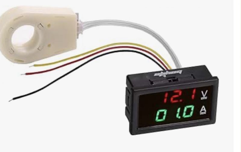

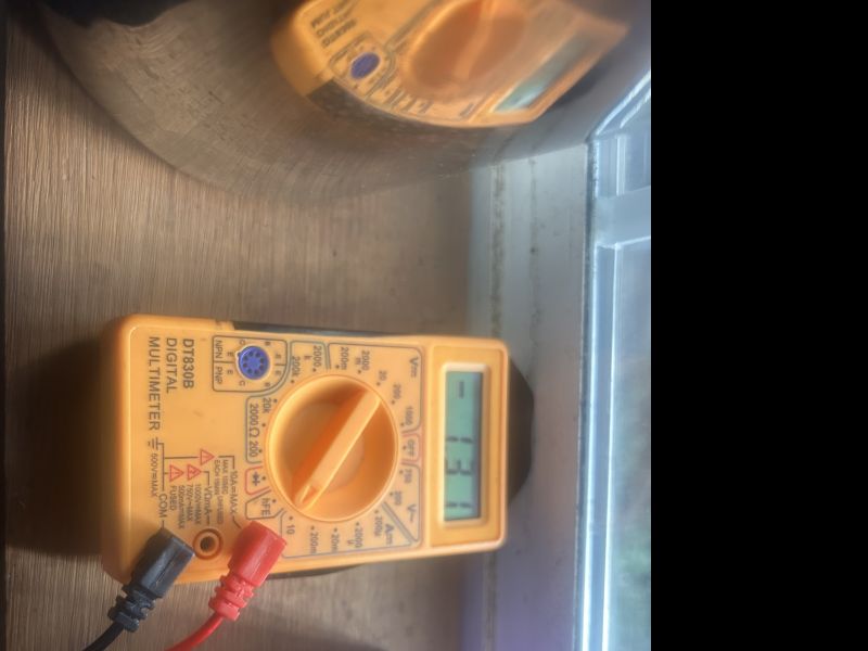

My battery bank lead runs through a hall affect ammeter. When I run the Meanwells 40amp charger it does read about 40.
# Posted: 8 Apr 2026 10:35am - Edited by: paulz
Little update. Yesterday morning I put the WiFi on a freshly charged Humseink sitting at 13.3. Ran all day, down to about 12.85 last night. Early this morning the WiFi died, battery showing half volt again. Hooked to the bank and it’s charging right up so far.
So only got about 20 hours out of the Humsienk . Upon close look the WiFi may be drawing 1.5 amps. And not sure how fully charged that 13.3 reading was. What’s that tool mention that tells you true charge? Something with a shunt..

A proper shunt with 3 decimal accuracy is really the only way to get accuracy after it has been calibrated with a high quality DVOM. Now a shunt this accurate is NOT cheap whereas a 2 decimal one is cheaper & 1 decimal one is cheapest.
13.3V = 3.325V per cell which is 0.075V below 100% SOC. Remember that 0.200V represents almost 50% if using factory spec that says 3.000VPC=0% and 3.400VPC=100% with 3.200VPC being 50%...

Thanks Steve. My clip over DVM only list AC amps. The cheapo clip on meter shows about 1.3. I’ll charge the Hummer to 14.x today and try again.

So this morning WiFi still going, Humsienk at 13.12. It’s been 3 days, and at the 1.3 amps I measured, should be closing in on the 100ah rating.
