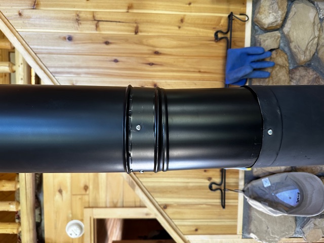

One more thing stove related... poor quality control... we had to put a new slip joint on the chimney pipe. Took it all down cleaned it thoroughly and reinstalled it. Couldn't get it straight. My friend says push it right... I look up and now the stove pipe is crooked going up to the collar. I straighten that and he's says no, push it back. I step back to see what he means and I notice it.... the collar that is attached to the new slip joint is put on crooked! (See pic) We had not beat on it or anything!! We could push back and forth all day and never get the pipe straight! Next trip to town this one goes back!
