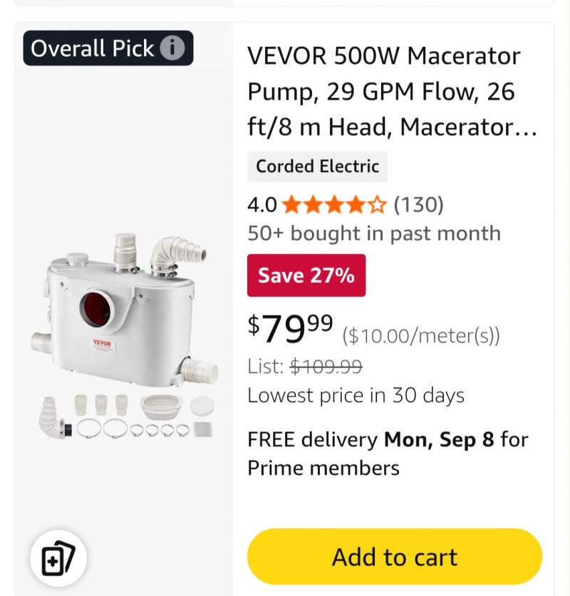

# Posted: 3 Sep 2025 07:39pm - Edited by: darz5150
Possible macerator pump. This one is for RV so 12 vdc. But others available on Amazon.

Have you called another septic company? RV macerator pump should work fine. Theres still going to be alot of liquids to deal with.

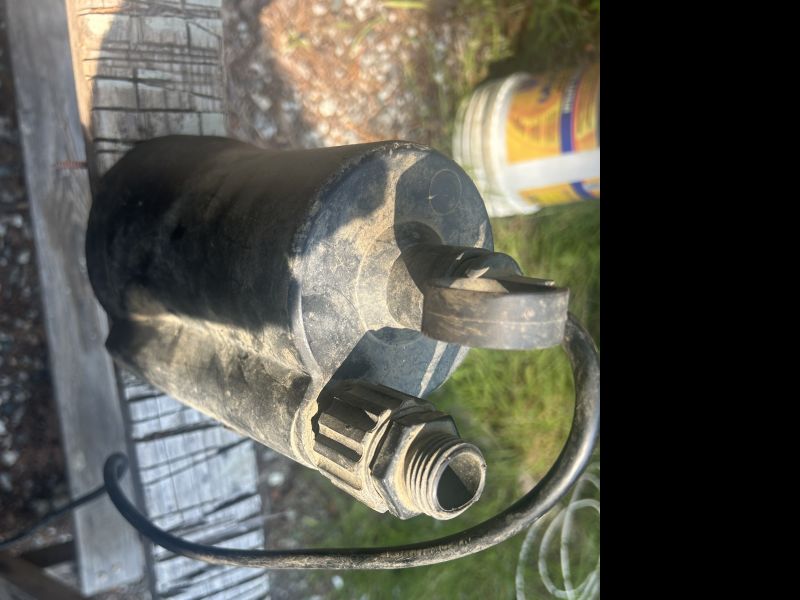

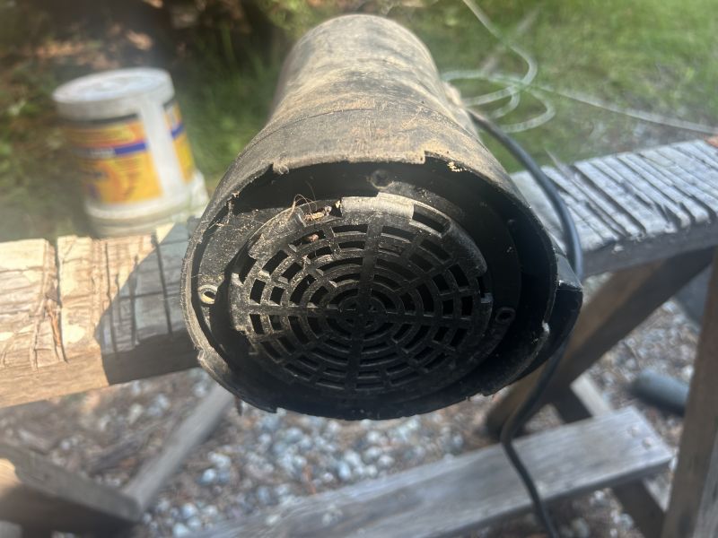

# Posted: 12 Sep 2025 07:27pm - Edited by: paulz
Late to the party but heres mine. 110v, garden hose hookup. It will handle anything that will flow. No brand ID, sorry.
