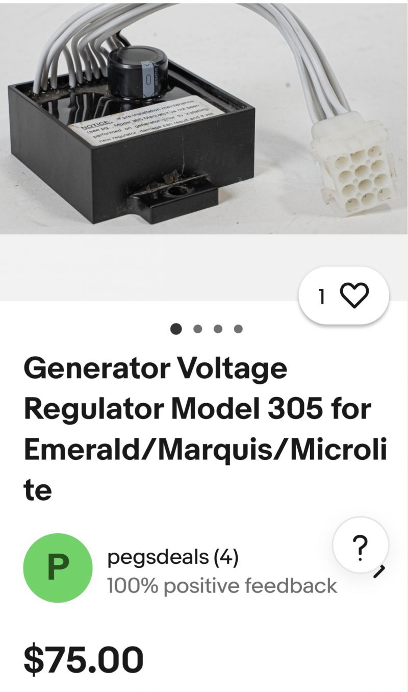

# Posted: 5 Nov 2025 02:51pm
Bought a used one on EBay this morning $75. It’s a gamble. It’s a complicated part, check out all those wires, not your usual plus minus charge terminals.
Price of dinner for two these days, worth a try.
# Posted: 5 Dec 2025 07:10pm - Edited by: paulz

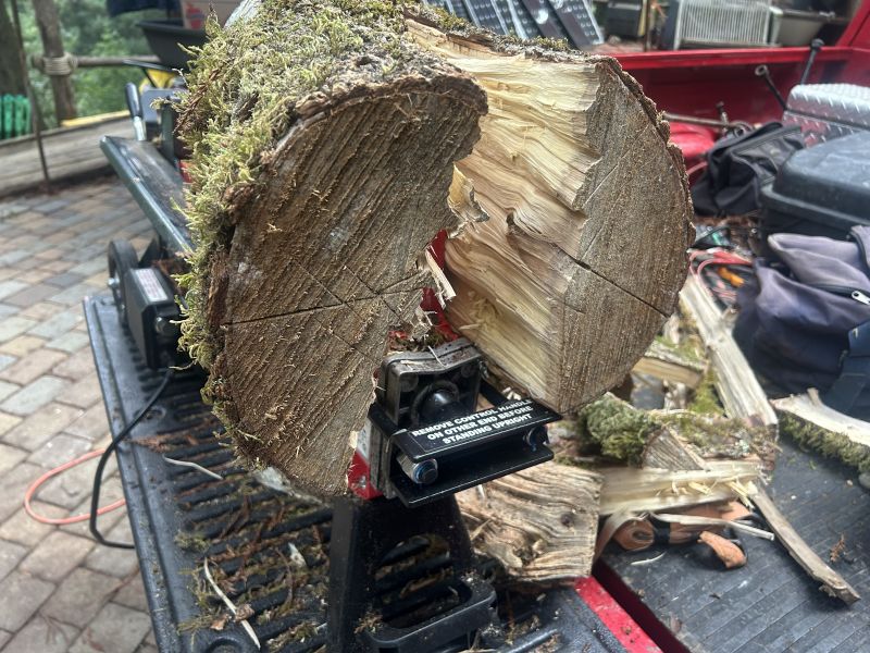

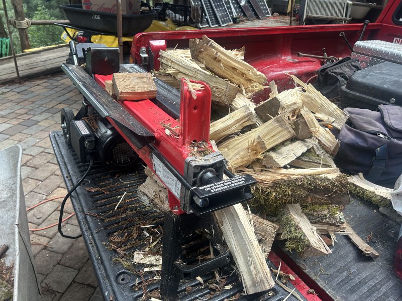

Hauled the dead lp Onan to the house for further troubleshooting. The diesel genny is doing fine, back to splitting wood*. It took several cranks to fire up from cold, there is no preheat on the key switch, nor glow plug I see. Just a cheapo I guess.
•this is about as big a chunk as the 110v splitter will do. Good enough, haven’t used the gas splitter in a long time.

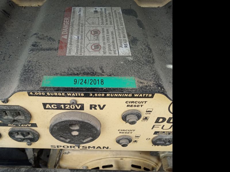

I dug out 3 manuals for different Gennys.
Sportsman 4000
Sportsman 4000
Steele 2000
Steele 2000
Sportsman 1000
Sportsman 1000

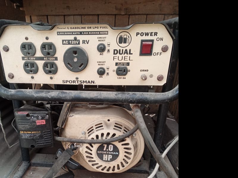

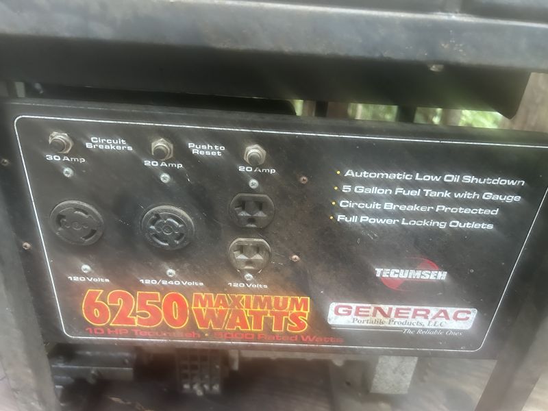

Playing with an old gas generator, what I thought were two 220 outlets, one is clearly labeled 110. Did they use this style in both?
# Posted: 23 Jul 2026 12:46pm
L5 L6
# Posted: 23 Jul 2026 10:50pm
Are you wanting to use it for something?
Or just trying to figure it out?
# Posted: 24 Jul 2026 10:31am

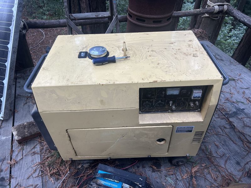

Im using it Darz. Its the old genny out of the well shack. I moved it up to the cabin and put next to the sketchy diesel gen pictured above which has actually been working fine in the summer weather. Anyway I needed a plug for the cord and have a bunch of these 3 prongs, and i only use 3 wires for the 220 so thought Id use that outlet, until I noticed it was labeled 110v.
Found a 4 prong plug so Im good, up and running. Just seemed odd they would have same style plug for both voltages. Keep plenty of gasoline around, diesel for the other genny not so much. Im an inch away from buying a new LP genny as soon as these take their last crap.
