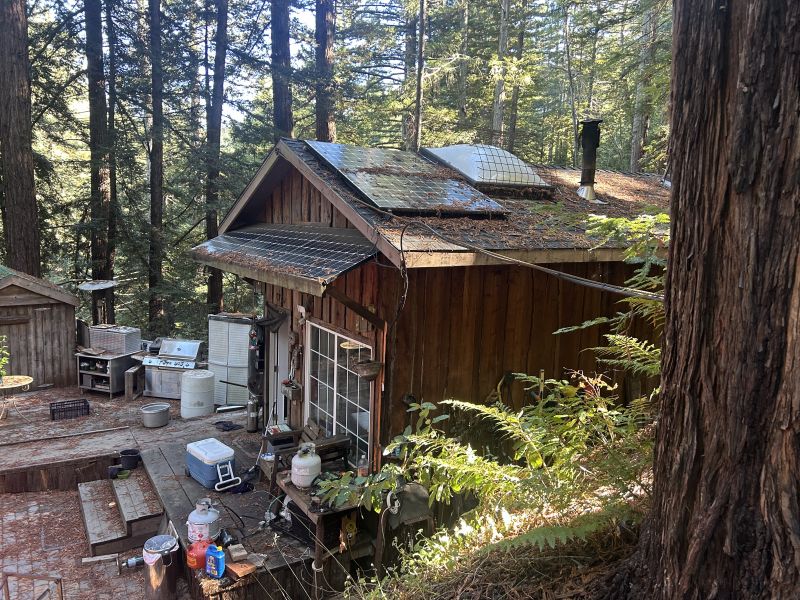

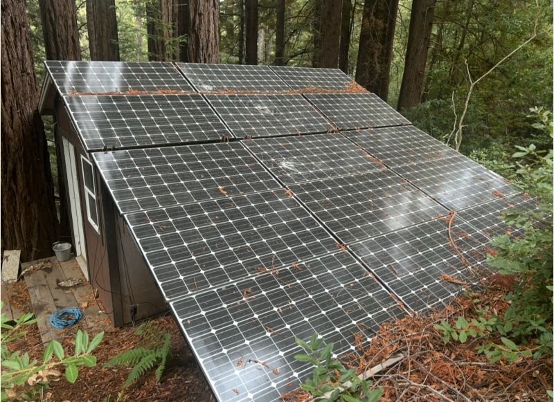

# Posted: 29 Oct 2025 04:53pm - Edited by: paulz
Center of roof to the ground! Kidding, that’s my main array on the storage shed. Got a few more on the cabin roof, just enough room to walk down the top center, no eve overhang, not that it would matter. Porch overhang is just panels, just wood frame under.

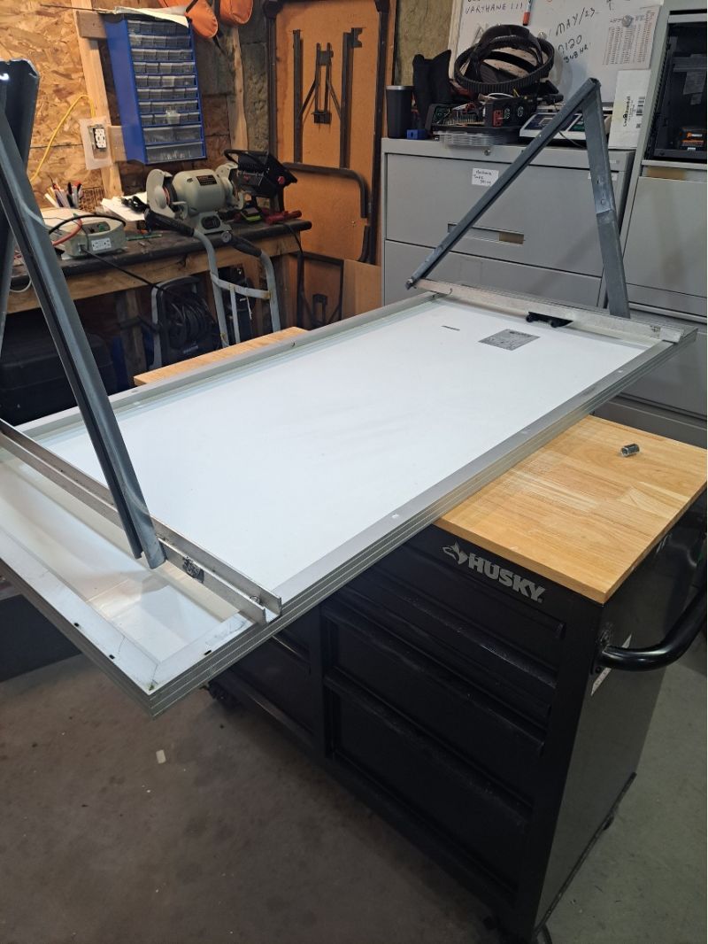

Sorry, was in a rush, here are the two options
# Posted: 29 Oct 2025 07:11pm
I like #2
# Posted: 29 Oct 2025 07:13pm
Paul, Im AMAZED you get any solar production!
# Posted: 29 Oct 2025 09:33pm - Edited by: MtnDon
My panels came with a fairly detailed instruction set showing the manufacturers designed positions for mounting the panels using several different arrangements depending on the rails or clips being used. The older cabin panels had a smaller range of allowable positions than the more recent panels for our home. My understanding is that the engineers specify points that maintain best strength for resisting wind, hail and snow loads.
travellerw
# Posted: 29 Oct 2025 11:49pm
If you look for the datasheet on the panels it will detail what is supported by the manufacturer!
Usually mounting through the holes in the back of the frame requires 8 mounting points. 4 mount points is only supported if using clips that wrap around the frame and hold from the front. (However, it does depend on the panel size).
Of course many people don't follow those instructions and are fine for years.
To your question. I would use the 2 mounts in the middle.

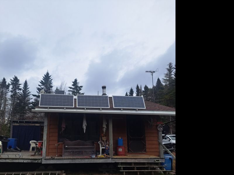

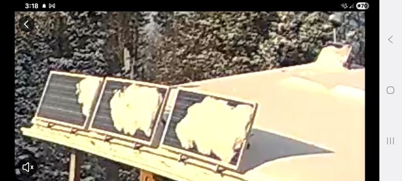

I got the panels mounted. I wanted them mounted in such a way that they would shed snow, the panels flat on the roof do not. Seem to be working.

# Posted: 21 Dec 2025 11:49am - Edited by: kittysmitty
Picture from the back

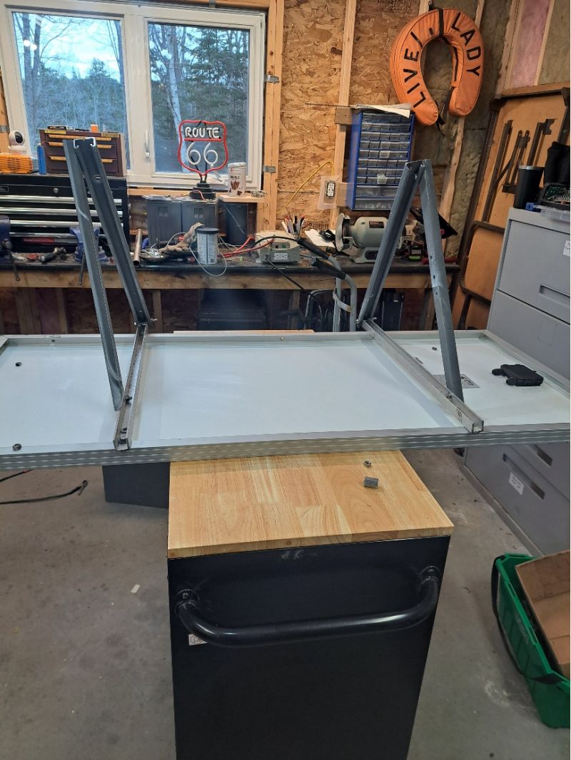

# Posted: 21 Dec 2025 11:52am
Mount from back
