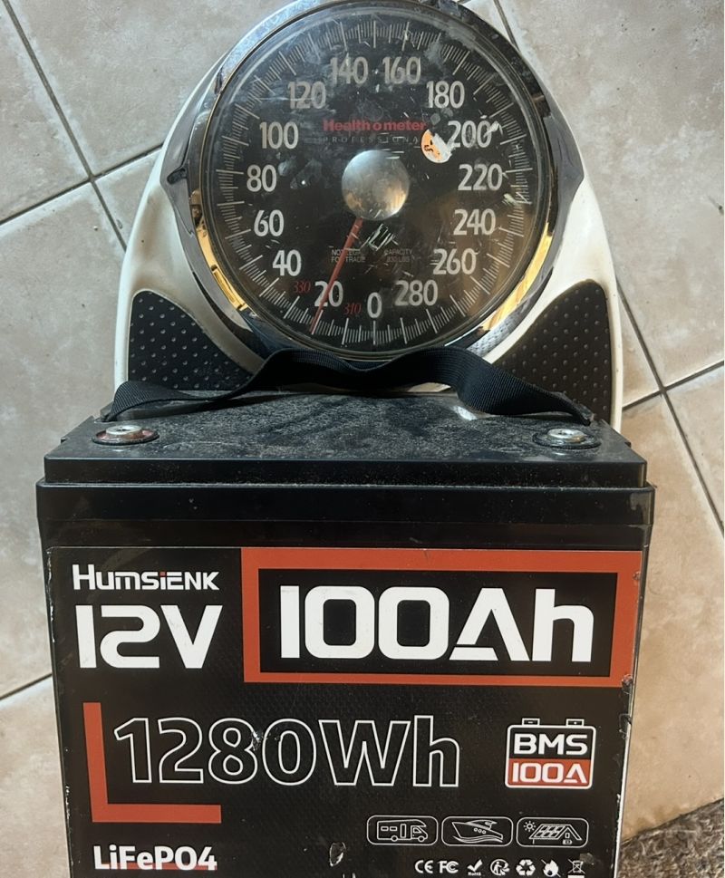

# Posted: 16 Nov 2025 05:12pm
20 for 100ah

# Posted: 17 Nov 2025 11:12am
use a large enough gauge AWG cable (not solid wire) in
Couple weeks ago I wanted to chain 3 LFPs to test. In the shop all I had thick enough was solid copper wire. Looked it up, said it carries as much or more current as stranded.
Other reasons for stranded of course. Didn’t do either, but surprised me.
