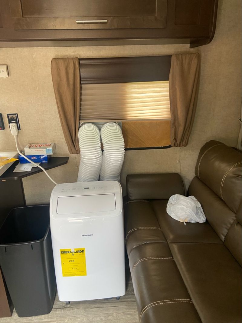

Our positive experience with this unit got me thinking about the air conditioner for the camper. The one that came with it from the manufacturer was a 13,500 BTU Dometic. Several years back I had installed a soft starter that allowed us to run it off a 2200W Honda generator, but I’m all in on solar and I wanted to figure out a way to run the camper A/C off solar like we were doing with the cabin. Inverter based roof air conditioners are just starting to hit the market. They are very expensive. Ultimately, I purchased a portable air conditioner that ducted out the window. I was able to custom adapt piece of plywood as a window insert. The unit for the camper is smaller only 8000 BTU, but it seems to hold its own. I’m in Minnesota. Maybe it wouldn’t keep up if I was down in Arizona. The portable A/C does take up a little bit of floor space in the camper but it’s a trade-off that I was willing to accept. Like my experience with the window unit this thing is very quiet. Much quieter than the factory air-conditioning.
Over the long Fourth of July weekend earlier this month I was able to give the camper air conditioning it’s first full test and I am very pleased with its results. Once it’s up and running, it’s humming along at about only 500W. For reference our camper is a 12v system, the inverter and solar components, for both systems are all Victron. It has 1050W of solar and 628 amps of battery. The portable AC was also purchased from Costco. I think each unit was on sale in the $350 range. I can’t remember the pricing exactly but the ability to control heat when it’s 90° out is priceless for the rest of the family.
Maybe the people that are deep into solar are aware of this, but I thought it was worthwhile information to know how much more efficient the inverter based compressors on newer air-conditioning units can be.

Hisense A/C unit
Hisense A/C unit

For reference, these are the two units that I have purchased: Midea 12,000 BTU Air Conditioner MAW12V1QWT
Hisense 8000 BTU portable Air Conditioner HAP0824TWD
I’m sure there are many others that are viable options. I think of it more of an endorsement of the quiet and energy efficient inverter technology, and not necessarily the exact units that I purchased. The inverters use a variable speed compressor, so they don’t have the spike in amperage when the unit first starts. This makes the technology a more suitable companion to off grid power.
