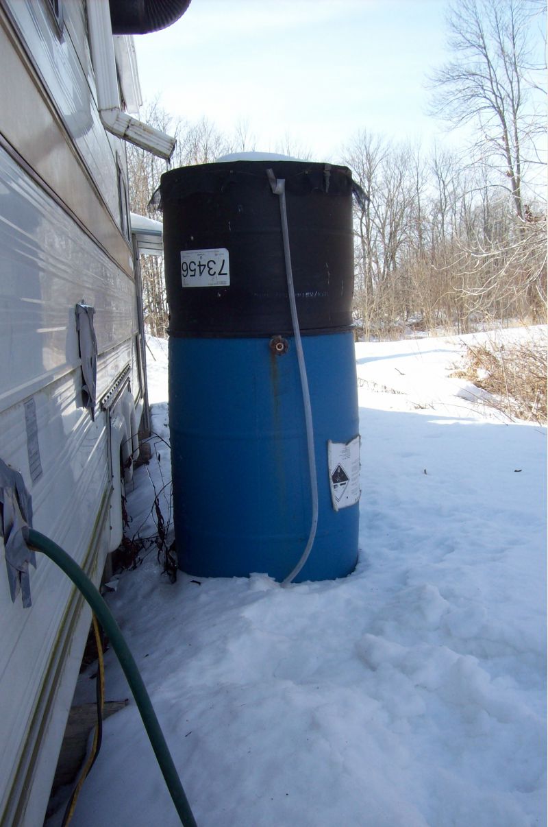

in this pic the short gutter is in place i have a longer one that rests on the back edge of the tank and carries the water 2 feet past the footings. i have a screen on top of the tank,, never plugs ,,the camper is in a thick bush with lots of leaf's it seems to self clean

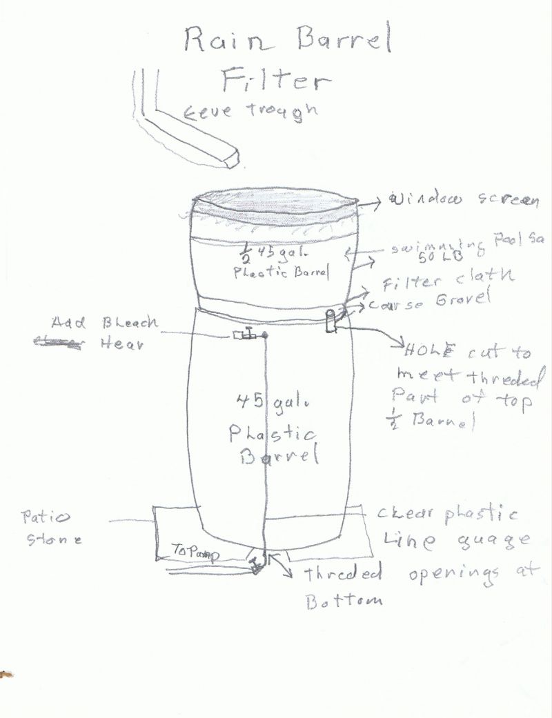

found this might help
