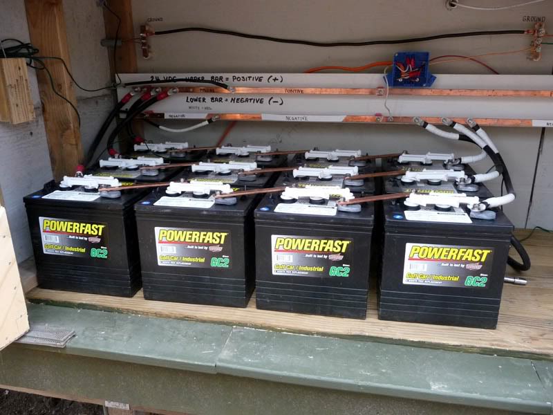

# Posted: 6 Sep 2011 11:19pm - Edited by: MtnDon
Better would be to use a buss bar system. That's where you have a positive and a negative copper bar or strap, sized to be able to comfortably handle any load and any input current with very little resistance. All devices attach to that, the charge controller, the batteries and the inverter. There is minimal resistance to current flow when the bars/straps are properly sized. The wiring is also neater when the number of batteries increase.
In the above two 12 volt battery system, one other advantage would be that either battery could be removed from the system if ever necessary, without interrupting any other battery or device.
Here is a photo of my buss bars and array of twelve 6 volt batteries (24 VDC system). Buss bars in the background. Note the use of copper straps for battery interconnects in place of battery cables. They were actually cheaper than quality cables.
FYI, white tape on the connecting cables is the NEC convention for marking the negative wires. Positive is always black or red under the NEC and white is reserved for neutral in SAC and negative in DC.
12 x 6 volt for a 24 VDC system
