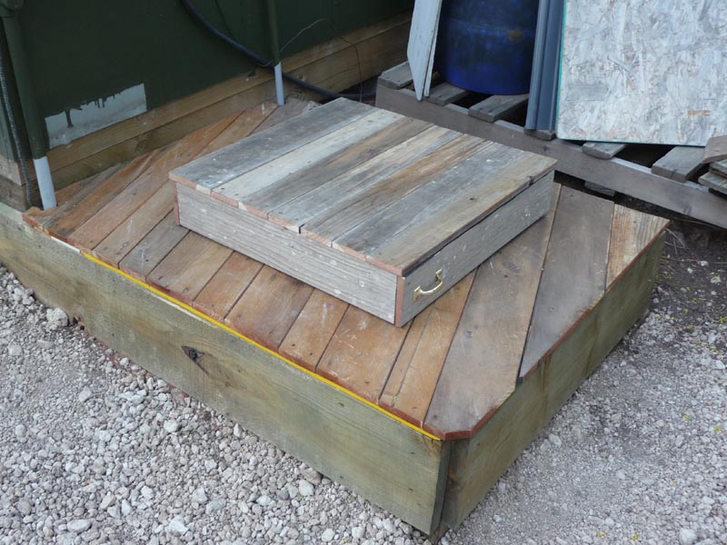

We have a three season road access property in the NM mountains. We would like to snowshoe in every other weekend. We do not like lugging in heavy foods on snowshoe. Foods that can be stored without concern about freezing give a limited diet choice. We've used freeze dried and find even the best to be unexciting to put it kindly. We usually eat fresh or frozen produce and meats. For a use such as this winter thing, there are a wide variety of acceptable canned foods available. But they can not be left to freeze for the most part. I do like hiking and snowshoeing; I simply don't like being a packhorse.
I was wondering what others who use their cabin once in a while in the frozen winter do. I assume that most folks, like me, do not consider leaving propane heat on all winter to avoid the freezing problem.
I do have a solution I hope will be a success. It involves digging a deep hole and insulating the top. Here's a photo of the upper end.

I think you are on to a great idea here. At our hunting camp we try not to leave anything water-based in the place over the winter. We've even had bottles of dishwashing detergent freeze, break, then leave a real mess after the spring thaw. I would think digging a hole at or below the frost line, and insulating it, would do the trick nicely.

Take a look at the concepts behind Frost Protected Shallow Foundations in the link below. You should be able to create a much shallower frost free storage area with the judicious use of extruded polystyrene foam insulation.
# Posted: 13 Sep 2011 11:39pm
It could be made to work, I believe it might be more work though. The FPSF design for an unheated building requires much more foam insulation both in thickness and the horizontal plane. I think it might be best suited to a building on a slab or full perimeter foundation, where a chamber could be built under the floor. My case situation is that I already have a pier and beam foundation building; not suitable.

The key is to dig well below the frost line, and yes, insulate the top.
My grandparents had a large full height storage room under unheated small building / garage. They kept all their supply there over the winter, without freezing - potatoes, beets, apples, canned foods, barrel-pickled vegetables, etc.

UPDATE: This has worked well for us. The lows had hit just below zero F and the temp in the tube was running at 40+ F (low forties)

We have a crawl space inside the cottage that is approximately five feet deep. We insulated the lid and the upper three feet. We keep our 100 gallon water tanks down there and the 12 volt pump system. We have had no problems with freezing and it does get to -20 c or colder outside. We have stored some food down there without incident as well.
