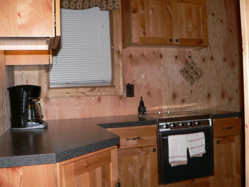

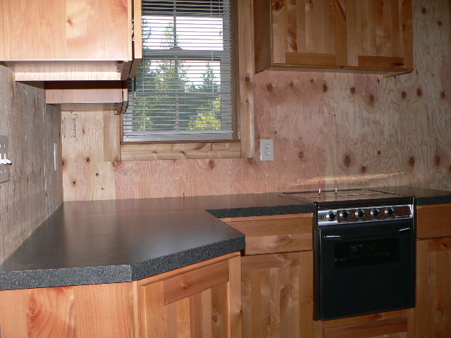

 Quoting: Talkbluffprez I am looking for recommendations on a propane stove/range for my cabin. I would like something w/ two burners (front and back) and a small oven w/ an overall width of ~20 in.
 I got an RV unit, it will cost you about 350 new  for a Magic Chef. You will need to have your countertop made for it. Usually, ovens go all the way to the floor, these dont, so I have a special under range drawrer built. Then I just needed 1" clearance on each side. Was actually pretty easy to do.
 I used 3/8" copper gas line from Home Depot, used my double flare kit from work, was a snap. Anchored the line using those metal bands with rubber on the inside  (dont want dissimilar metals touching, or you get corrosion)
 I bought mine used for $100. Newer ones might want to see some electricity, I wanted it to work without any electricity. It can be set up for either pilot lit under lid, then just turn the burners on and they light or you can adjust a small screw and close the pilot circuit and then manually light each burner. Oven has a pilot, and it must be lit if you are going to use it. The oven knob has a "pilot off" setting too, so you dont burn propane when not in use.
 I will install one of those ventless RV stainless hoods for it next spring.
 http://www.pplmotorhomes.com/parts/rv-stoves/rv-range-amana.htm
 |  Magic Chef 21"
 |  Before formica covering

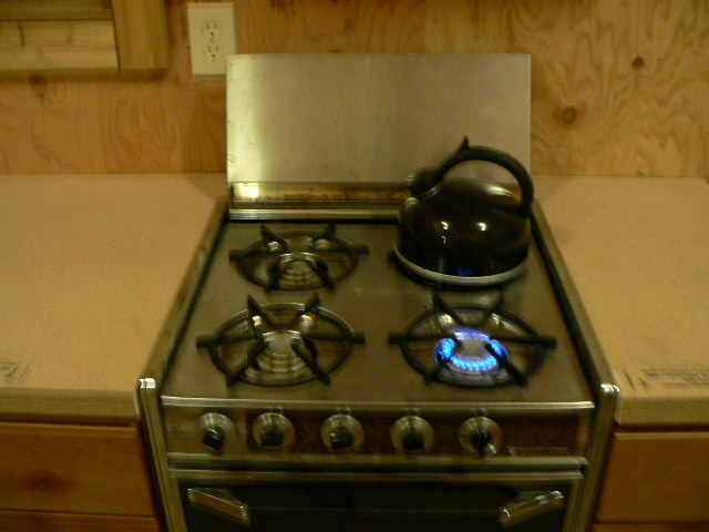

 | # Posted: 28 Sep 2011 11:04pm - Edited by: TomChum Reply
 Here's a small range, 3 burner.  It has piezoelectric start (no electricity req'd).  I'm pretty happy with it. Except I wish the grille was Stainless Steel, the enamel is already burning off.
 Atwood RV-2135 BBP Atwood RV-2135 BBP 51718 21 Inch 3 Burner Wedgewood Vision Range Oven Black Top Black Door Piezo Ignition Trailer Camper RV $479.00 from sales@americanrvcompany.com
 Just after I bought it, I saw an RV range on craigslist, ----->claimed to be in excellent condition, for $150 but it was far away.  Have to think about that part of buying from CL, plus it might need work.
