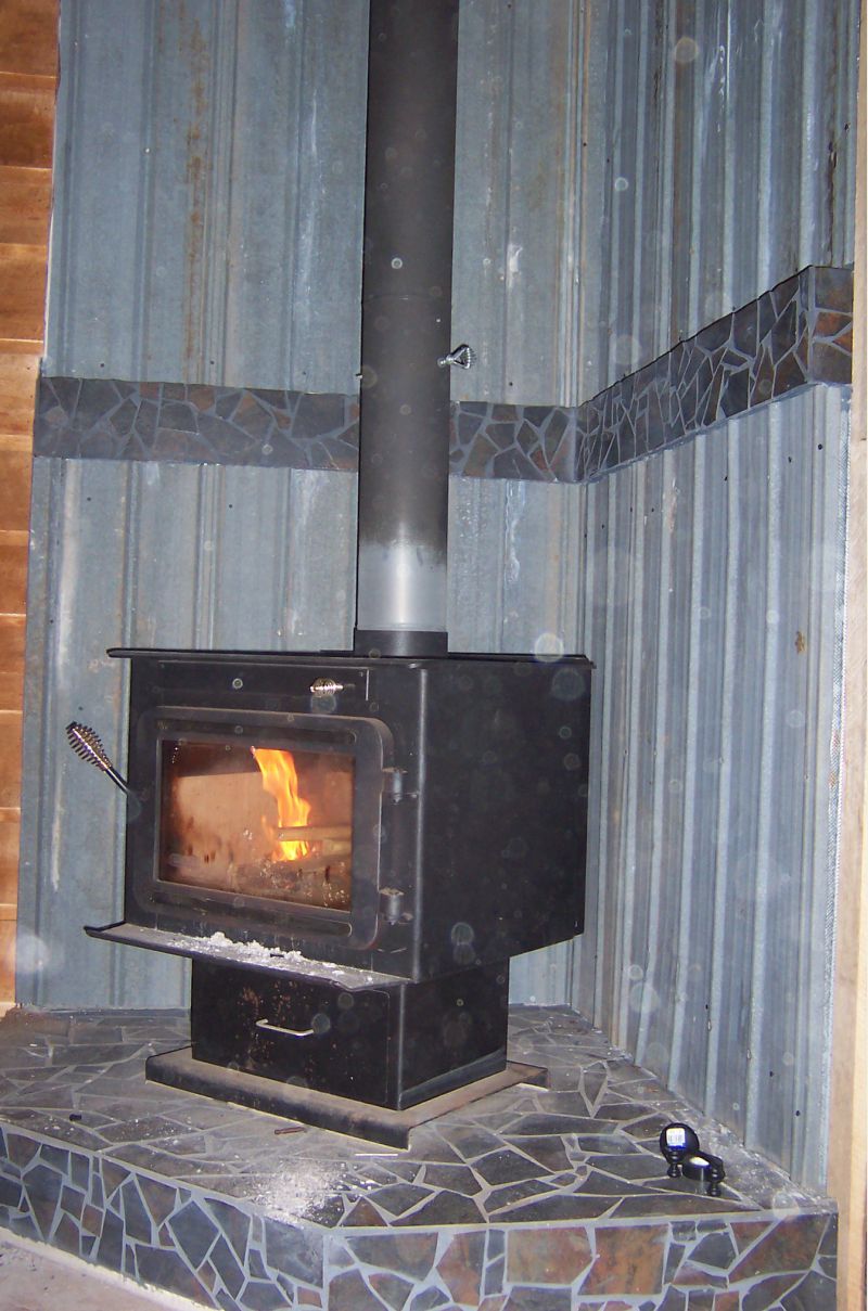

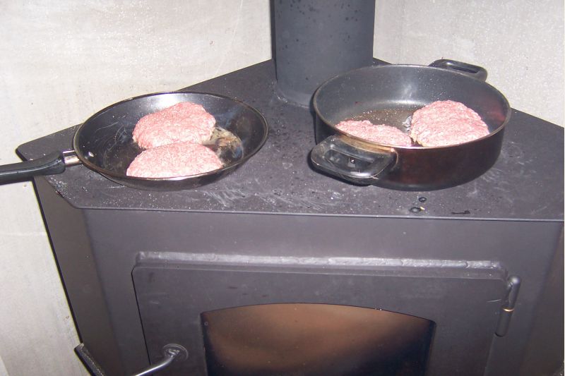

# Posted: 30 Sep 2011 12:12pm - Edited by: trollbridge
My vote would be wood stove with a nice window-we cook on ours too.
window
window
Burgers
Burgers
Burgers done!
Burgers done!
flapjacks and sausage

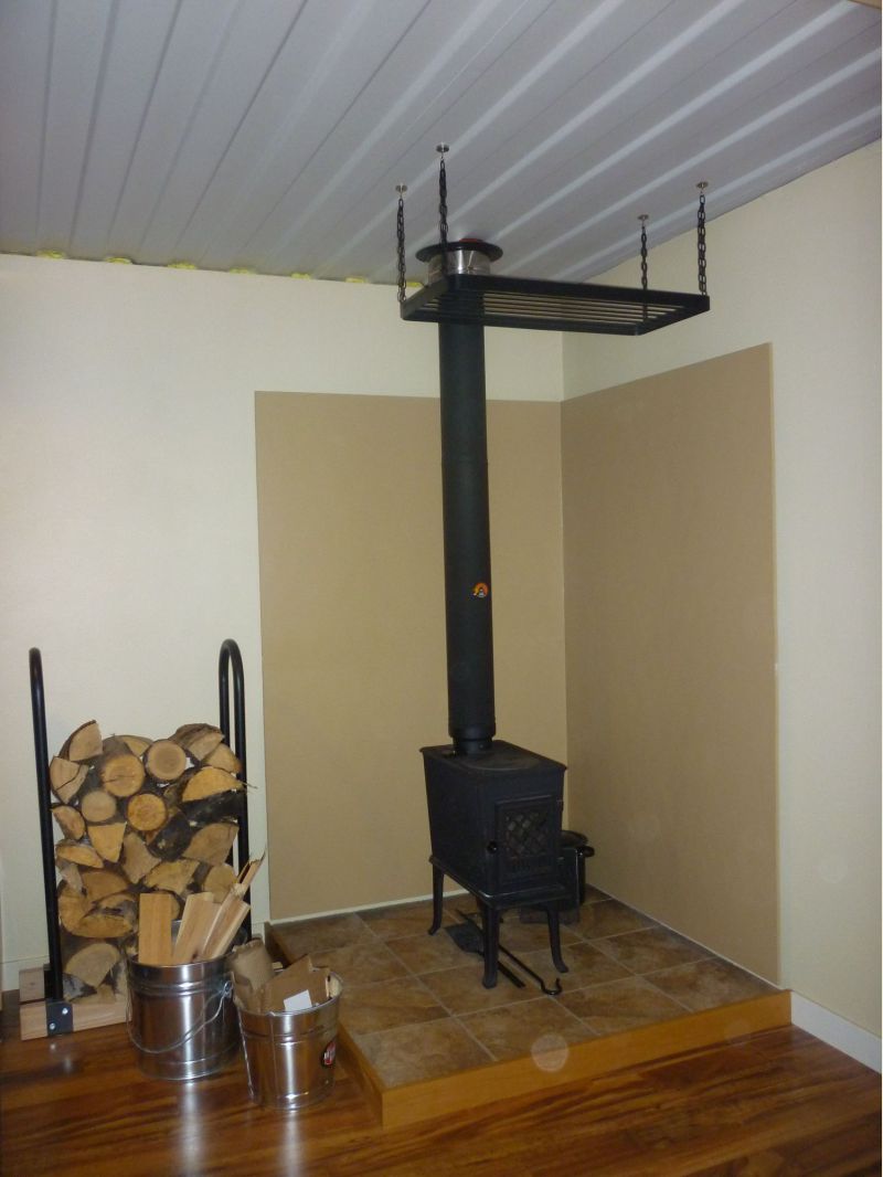

Steve961
# Posted: 30 Sep 2011 02:11pm
If you're looking for a high quality wood stove that should last a lifetime, I recommend the Jotul 602. It's the smallest one they make, and is more than adequate for your space. It also has a dedicated cooking plate on top. Mine is installed in a 450 sq ft cabin and has kept me warm through -10F nights in Wisconsin.
My Jotul 602
My Jotul 602

# Posted: 5 Oct 2011 10:47am
Steve961 whatis the purpose of the grate suspended from the ceiling around the stove pipe? Is it a drying grate? Sorry for stepping on the thread, but curiosity has got the best of me.
Steve961
# Posted: 5 Oct 2011 11:01am
exsailor:
It's an Ikea KROKEN hanging pot rack that I'm using as a drying rack. It was only $25 at Ikea and is the perfect thing for drying wet gloves and socks in the winter. Unfortunately it seems that Ikea has recently discontinued it.

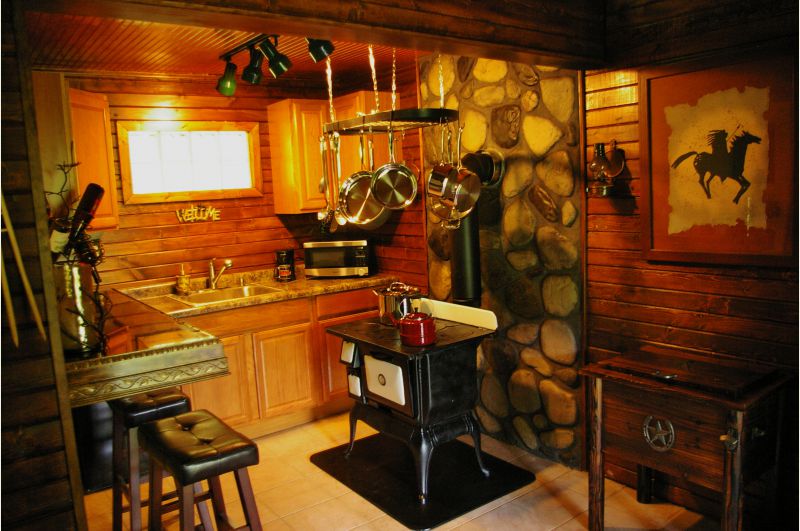

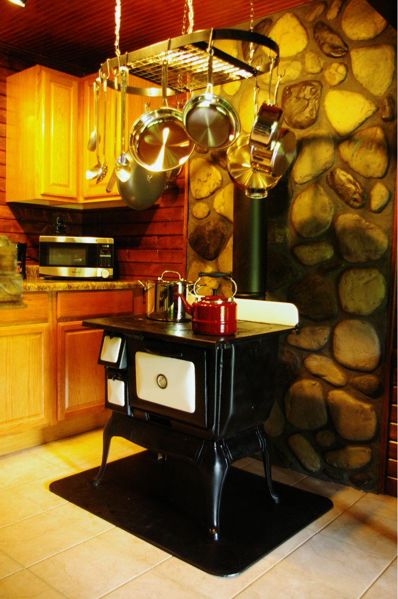

# Posted: 9 Oct 2011 09:20pm - Edited by: dfosson
My 16x24 cabin has both a fire place in the main room and a wood stove in the kitchen. The kitchen stove was a Craig's List purchase for $200 and is the pride of the cabin. It not only heats but does a great job on biscuits and corn bread.
Stove is center of attention
Beulah the kitchen stove.

Sweet stove -- 200.00 without all the piping I assume ..

That stove is a beauty!

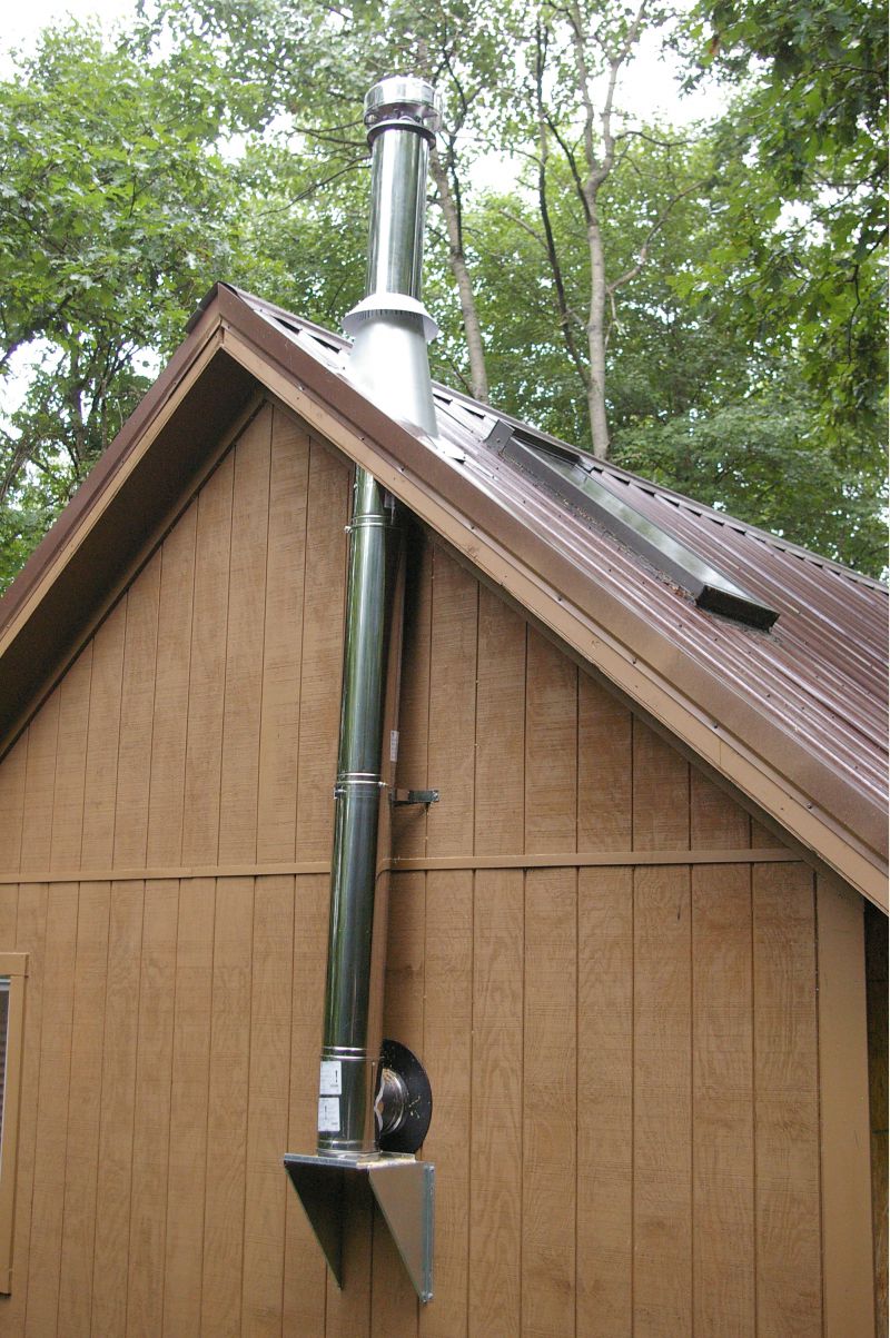

dfosson
# Posted: 11 Oct 2011 04:55am
Although it came with single wall stove pipe, I installed double wall both inside and out.
kitchen stove pipe
kitchen stove pipe

Spudmasher1
# Posted: 18 Jul 2012 05:42am
What is the brand name of the corner woodstove the burgers are cooking on? Where did you buy/get it? Do you know if they are still available?

# Posted: 18 Jul 2012 12:19pm
Spudmasher1.
Thank you for the interest in our corner woodstove. Unfortunately I can not help you as we did not purchase it, our son custom made it for us. It is in our bunkhouse and we needed something small. He built a similar one for his ice shack and we asked him to build one for us too.
In our main cabin we purchased one just so it would pass with the building inspector and meet insurance requirements but I like the original much more! Not only do I think it looks nicer but it seems to hold longer logs because of the angled box.
Not sure why a corner unit isn't standard on the market. I would think there would be a market-especially with us small cabin owners!

dfosson
Everytime I see the small cook stove inyour cabin, I get curious. Do you have any idea who the manufacturer is? Any idea how old it is? It looks like there is a small oven as well. It seems perfectly sized for cabins. As you said I really like the heating cooking purposes. I am looking for a wood cook stove. It will eventually be in my future cabin, so I have time to find one. Thanks for any information you can provide.
Spudmasher1
# Posted: 19 Jul 2012 02:29am
Trollbridge Thanks for the info. You are right I think there would be a market for this corner style of wood stove. Someone need to take this idea and run with it. It could be a million dollar idea??? Doug
# Posted: 19 Jul 2012 10:08am
Hmmmm...maybe my son should go into business for himself making these stoves.....
