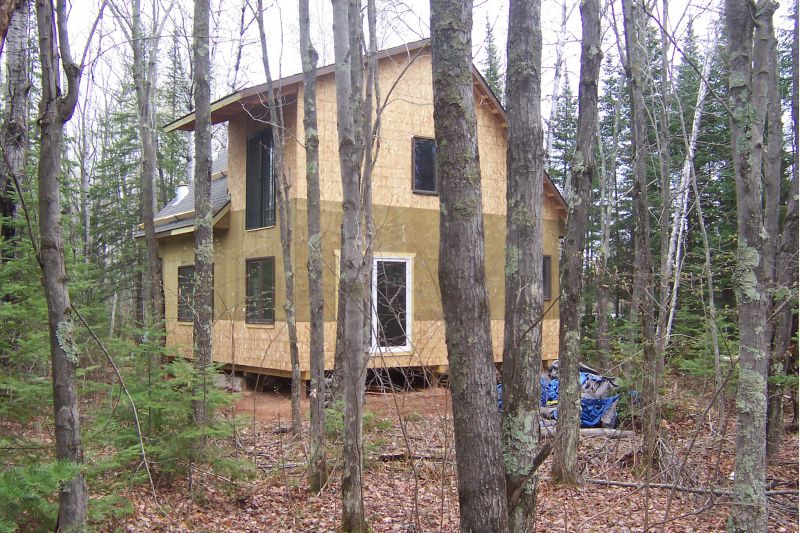

 Hinged on the wall would be easier to tend to for us. The best portion of roof for solar panels at our cabin would be the roof over our loft dormer. It would get the most sun there but is very difficult to access. We don't have a high demand for electricity since we do not have utilities, but like you said, in the winter it is dark so early that lights are more necessary.
 suburbancowboy, are the panels on your trailer the ones from H.F? They look very large to me-approximately what are the dimensions?
 BTW Bugs, if you don't go to your cabin all winter, what wonderful pictures of wildlife am I going to get to look at???!!
 |  This side face mostly south
