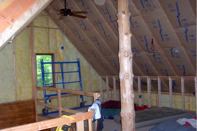

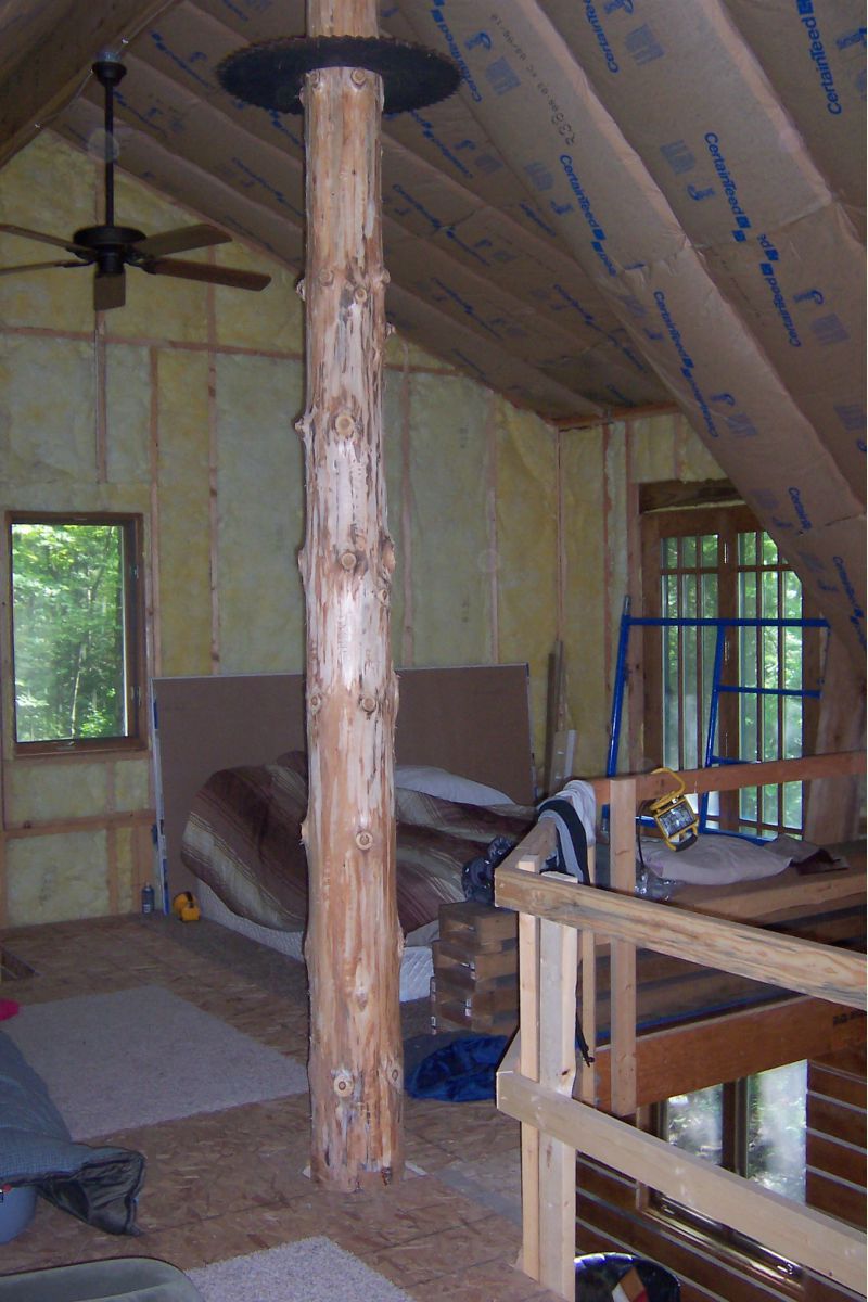

Thought I would pass this info along, it may help some of you having trouble getting your cabins warmed up with your wood stoves. We had some trouble too at first until we finally installed two ceiling fans up at the peak of the ceiling. We put one over the loft and one over the area that is open to below. Make sense? I'll try to find a pic. Anyways what we found was that it makes a HUGE difference for a very small amount of power-we can run both of these off our one (not very good) battery for the entire night. The one over the sleeping areas in the loft keeps you from getting baked and the one over the open area blows all that hot air down to the main cabin. It takes waaay less time now to heat the cabin up when we arrive on a freezing Friday night!! Hope someone finds this as useful as we did. Here's pics.
fan over main section of loft
fan over open section to below

Thanks for the info. We are planning a ceiling fan at the peak of the roof over the half loft region. Do you think we'd also need one over the back part of the loft? I can't tell from your photos how far apart your 2 fans are. Our loft space is about 20' (front 10' is half- with the rest open to below- where the stove is located and the back 10' is full loft, covering the whole lower level.) Thanks!
# Posted: 12 Oct 2011 01:30pm - Edited by: trollbridge
Hi! So your loft is L shaped like ours is. Our cabin is 26' long and both of our fans are mounted on our ridge beam and I'm guessing maybe about 12' apart or so. One is over the "full" loft section and the other is over the "half" loft so that fan circulates the air over that space but mainly blows all the hot air produced by the stove back downstairs(or keeps more of it there in the first place). If one fan is great then two are that much better right?!? Besides you have electricity so why not,plus you won't have to run both if you don't need to. Did it get hot in your loft this summer? Our fans are just as valuable to us during the warm months as the cold. Overall,they have been one of the most useful,convenient and cost effective purchases we have made for the cabin!
