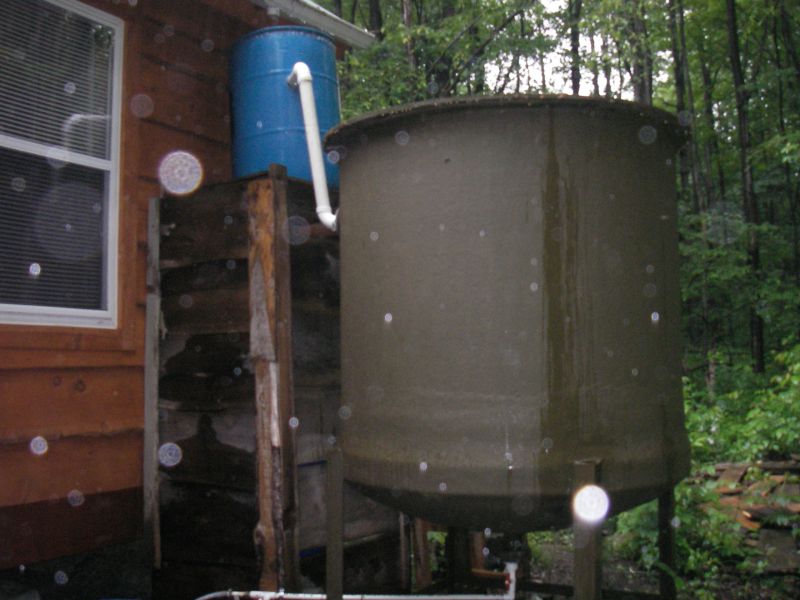

 The past three years I've just let it freeze. This has caused some damage to my tank's pipes which was easily repairable, but nevertheless I'm thinking of letting it drain this year.
 In order to keep from freezing, your best bet is to bury your supply underground. How deep depends on your location, with the best depth being below frost line.
 The inherent problem with this is the pipe from the below ground to your cabin. Maybe a heavily insulated pipe would work, but the trick is to allow the pipe to drain back into the tank when not in use.
 Another option if possible, is to pump water from an underground tank to an indoor tank.
