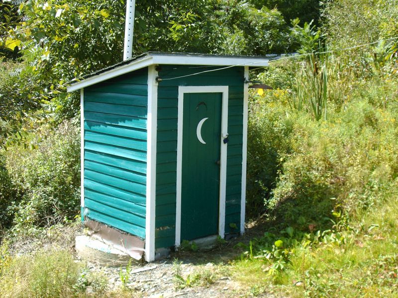

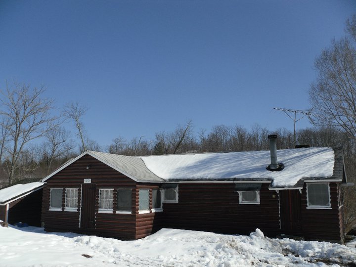

 thanks for help i will check that product out.  attached is a picture of my outhouse, which i need to re-side in the next few years and a picture of my cabin last winter.

 wow, that is a large cabin! It sounds like a very nice arrangement. Did you spend a lot of time there growing up? Where is your cabin? The snow is pretty.

 My cabin is in the Delaware state forest by Bushkill falls PA.  It is one of the larger one in the area.  It used to be two unites with each one having a kitchen, living room and bedroom.  I have combined the two to form a two bedroom cabin with a fishing room in one of the kitchens.  I have been going up there my whole life, I am very lucky.   Its about two hours from where I live by Philadelphia so I try to get up as much as possible, probably 15 weekends a year.
