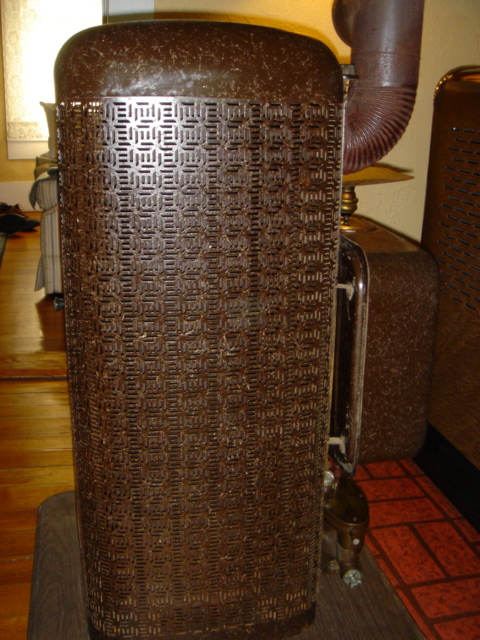

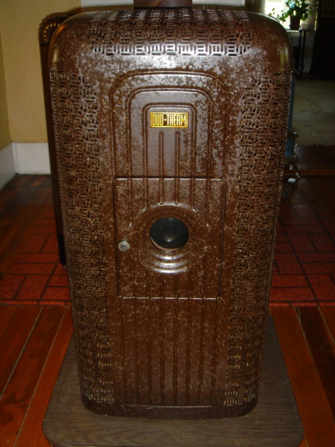

Included below is a photo of a small Duo Therm Pot Burner type heater which runs almost 48 hours on 3 gallons of kerosene or heating oil, it has a built on rear tank or can be piped in from an external 50 or 250 gallon tank. That run time is for the lower heat settings, on high you can expect to go though at least three times that amount of oil. Heaters with outputs up to 50,000 are commonly found in areas where oil heat is or was common.
Front view oil Duo Therm
Side  view oil Duo Therm
