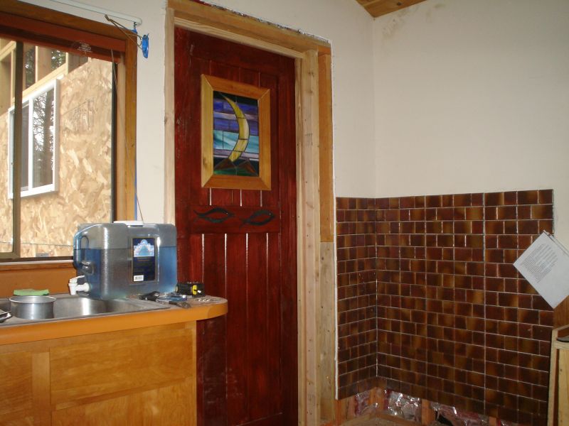

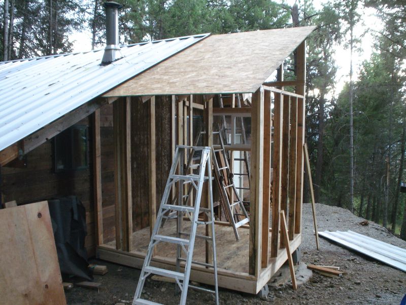

I put up an indoor out house. It is attached to the cabin with a door into the cabin. It has a RV toilet and a shower. For now it is all gravity feed with water containers.It sits over a cement tank. I can have it pumped just by lifting the toilet up and start pumping.![adding indoor outhouse adding indoor outhouse](https://www.small-cabin.com/forum/shared_files/uploaded/15/1705_1.jpg) adding indoor outhouse
| ![door going from cabin to the bathroom door going from cabin to the bathroom](https://www.small-cabin.com/forum/shared_files/uploaded/15/1705_2.jpg) door going from cabin to the bathroom

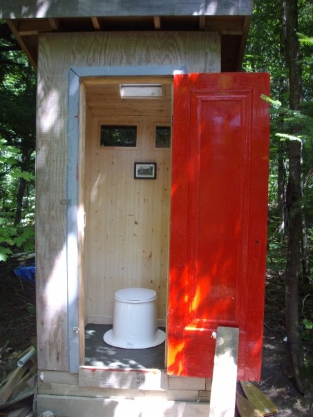

Thought I'd contribute to the outhouse stream. Attached is a photo of my "boreal biffie". Basic construction with a pressure treated 4x4 crib underneath. A fibreglas toilet cone purchased from http://www.farnorthfiberglass.com/cones.html makes it feel like you're using a real toilet. No fancy incineration or composting - just the old fashioned pit model. I have skylite in the outhouse. It was a miniature floor model used for promotion I purchased from my local building centre which no longer carried full sized models. Vintage postcard on the wall titled "Parry Sound Log Dump".
