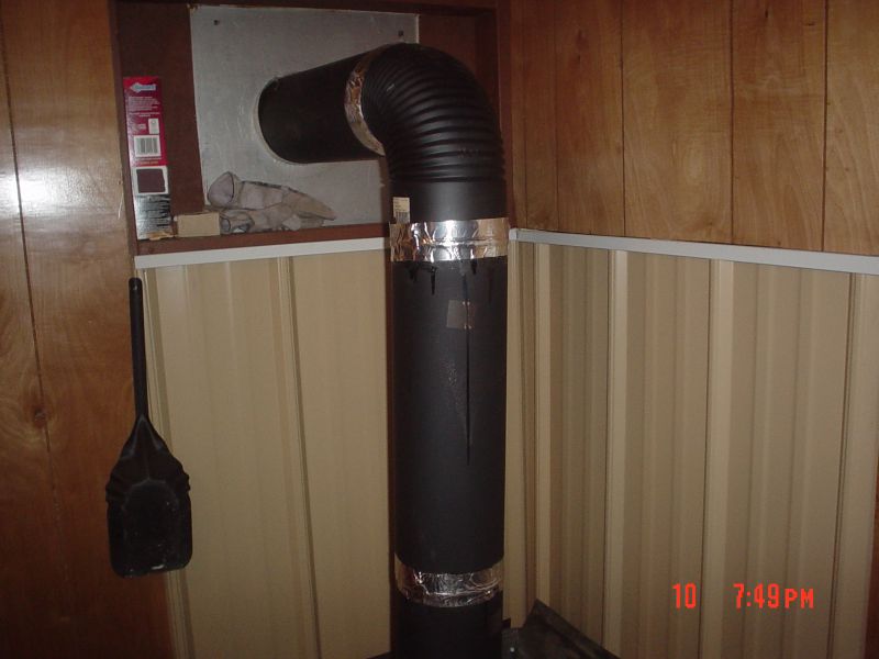

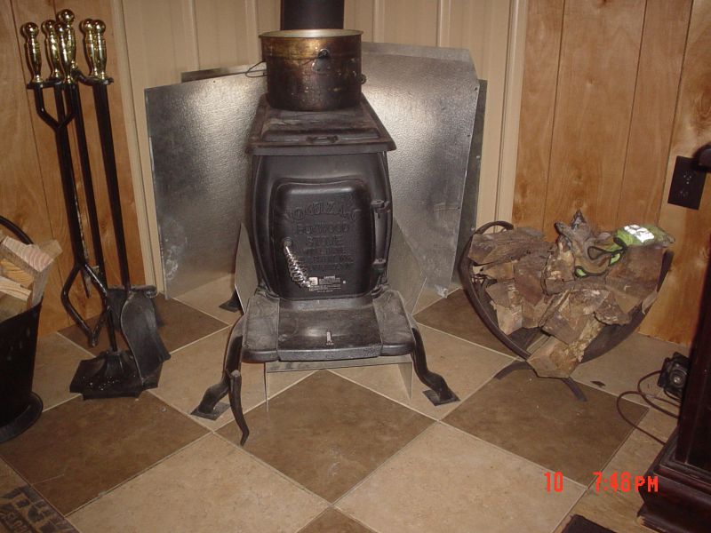

I have the vogelzang stove you mentioned. We like it a lot. It is in a room addition that is 12 x 16 connected to another room 12 x 16 also. I laid ceramic tile on the floor (4 feet by 4 feet) for protection against stray sparks and embers. The clearance on the back corners is around 12 inches. I put pole barn sheet metal in the corner behind it for added protection. I also have a moveable heat sheild to protect the walls when we have a bigger fire burning. I checked the heat around it with a digital thermometer when we had a raging fire going and the temp. by the walls never got over 140 degrees ( thats less than a medium rare steak ). I think I got the ideas for the heat sheilds from the NFPA 211 website that tells you how to cut down on wall clearances.
