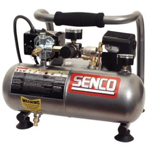

wakeslayer
# Posted: 7 Mar 2012 10:09 - Edited by: wakeslayer
Jeffgreef,
I think this is a perfect fit. I used one to blow my water heater and water system out. Portable, and doesn't take much juice to fill. I think an actual air compressor will ensure you get more water out than a hand pump. It also runs small airtools nicely. Lastly, it is very inexpensive.

Wakeslayer- I probably will benefit from having the compressor a lot more than I think during construction- finish nailer, stapler, etc. I'll put it on the long list....
