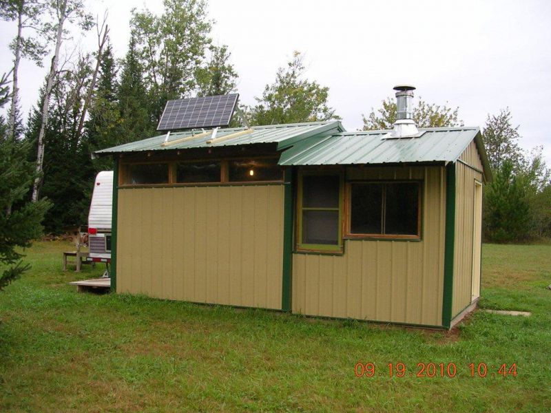

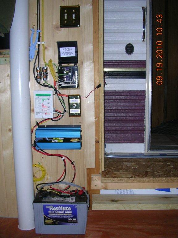

My 3 electrified Kero-LED lamps use (6.2+3.2+6.6=) 16W total, and I don't usually have them all on at the same time but all 3 lamps is much more light than the (diffused) Alladin. 4 hrs a day=64/12volts= 5.3 amp/hrs. My 85w panel puts out about 7 amps, so 4 hours of evening lighting is replenished by about an hour of the day's sunlight.
You can see the Alladin with its white diffuser on the table (not burning) A bare 2.8w LED bulb is hanging from a wire in this photo. It's a 2900K color bulb, looks a little more yellow than incandescent.
