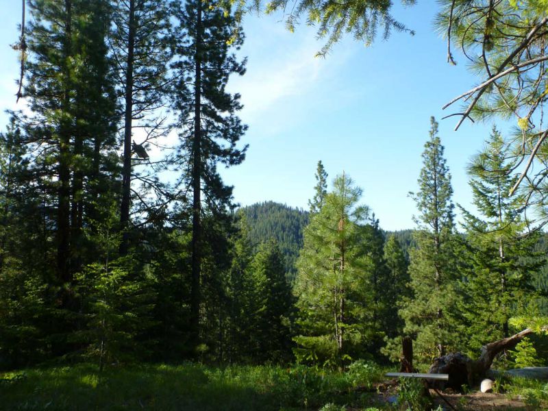

 I have an 85W panel 30 feet up high in a tree.  I chose the tree due to it's southern exposure and that it's branches were spaced like a ladder!  I climb the tree in the winter, and angle the panel to 45deg so the snow slides off.  The wire to my charge controller is 100 feet long.  If I had to do it again I would buy a 48volt panel which is better able to push electrons 100 feet.  12v seems like it might save money but it doesn't.  With 12v, the cost of 100 feet (=200feet) of fat copper wire costs more than the panel.

 Quoting: AlabamaDan Where I'm looking to build is in the middle of a forest and I doubt solar or wind would work well.If you have a big, climb-able tree it can work, for awhile.   I don't think I'll want to climb my tree after I'm 60.....
 |  Solar panel 30 feet up in a tree
