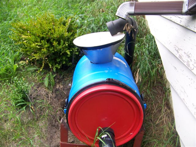

# Posted: 11 Mar 2012 01:59pm - Edited by: analogmanca
Self explanatory pic.12+ years no problems. Pic on right side is cistern(to dark to see anything) A couple very tiny pin holes driled into the bottom of the barrel just so it cant hold water between rains. Otherwise stuff would grow in the standing water in the hot sun. End of the barrel comes off for cleaning if needed (hasnt been)

# Posted: 11 Mar 2012 09:26pm
analogmanca: I'm looking at that picture and it's not self explanatory. Are you using the barrel as a first flush diverter? I don't quite understand what the pipe sticking up beside the gutter drop is from either. I'm usually pretty quick to catch stuff and this one is beyond me.

# Posted: 12 Mar 2012 01:16am
The 3 inch black pipe is from the eaves on the other side, I just put it underground as who wants to trip over it. 80 percent of the rain comes through that pipe,20 percent through the other.They both empty above a large funnel that is tilted a little bit. over top of the funnel is maybe 3 or 4 layers of fine window sheer cloth streched tight. Now imagine it raining, and a lot of water comes through that black pipe, and water is heavy, crap is not.
The water goes across the sheer cloth, and drops threw, but gunk just gets flushed off. Sort of self cleaning. cloth needs to be replaced every 5 to 6 years.
when the cloth is wet water goes threw no problem, but the cloth acts kind of like a solid surface to solid material.
analogmanca
# Posted: 12 Mar 2012 03:29am
I should add that Its not a first flush diverter as such as, I guess I could call it a always diverter as the water goes one way, and gunk the other. Though I supose I could just pull the lever that is holding the lid tight, and water would just spill onto the ground when It rains, and I could tighten it back up when I diverted enough of it, but I have found no need.
Sorry, I thought the pic would surfice, any other question ask away.

# Posted: 12 Mar 2012 05:39pm
I gotcha now. That's a pretty good system. Thanks for the clarification.

# Posted: 14 Mar 2012 06:27pm
Analogman: I see the 55 gal drum on it's side in that photo. What happens to the water from there? You said you have a hole in it to keep it from filling up between rains.

# Posted: 14 Mar 2012 10:26pm - Edited by: analogmanca
First, the barrel is on its side just for a lower profile. The bushes I planted around it will hide it in a few years.
If you look to the front of the barrel you will see the output pipe a couple inches from the bottom
of the lid.That output pipe just goes to the cistern(below grade), by gravity flow. Yes there are a few tiny, think very tiny pin holes in the barrel. not to stop it from filling up but to stop it from holding water, as after a rain there could be a inch or two of water in the barrel. You would not want this to stay in the barrel day after day in the hot sun so the holes just let it drip out.
Without moisture nothing bad will grow in the hot sun. also the sheer cloth dries out nearly instantly in the hot sun, again nothing to hold water,and grow things.
You do not need to tip a barrel on its side as I did, take a barrel and from the top slice it at a 20,25 degree angle.
Stretch the sheer cloth (a couple layers) over the openning. or make a lid with the cloth stretched over it.
The gutters empty over the high spot, with gunk just flushed off the low side to the ground. You might need to add a wire screen under the cloth as that is a large openning.
