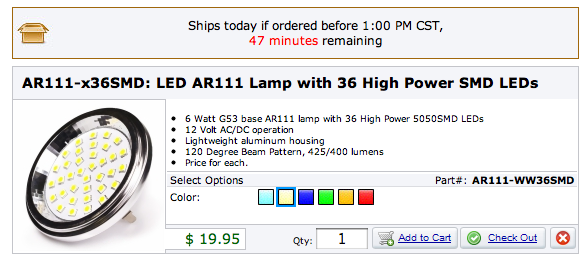

AR111-WW36SMD  If you want to try ONE 12v LED, start with this one. Note it's "warm white".

The little 1/5w and the 6W LEDs from superbrightLEDS are "flood" or 120deg. In my opinion, the AR111-WW36SMD ($19.95) from SuperBright LEDS is the best light to buy, today, if you want to save watts and light your cabin nicely. There are others, but these are the only ones I have experience with.
For a direct comparison, it's 6w and I think its brighter, and gives much nicer light (color) than an 11w compactFluorescent. And it runs directly on 12vDC, using tiny wires. Speaker wire is "huge" for this light, you could run these lights with tiny telephone cable (if you run wires in your cabin, especially if you choose tiny wires, be sure to put a tiny 2A or maybe 5A fuse at the SOURCE!). And while you're at it, order some of the "Little Dot" LEDs "LD1-WW" ($1.99) to fill in some shadows or light your woodpile. This is my advice to someone who wants low-cost but very nice small cabin LED lighting.
