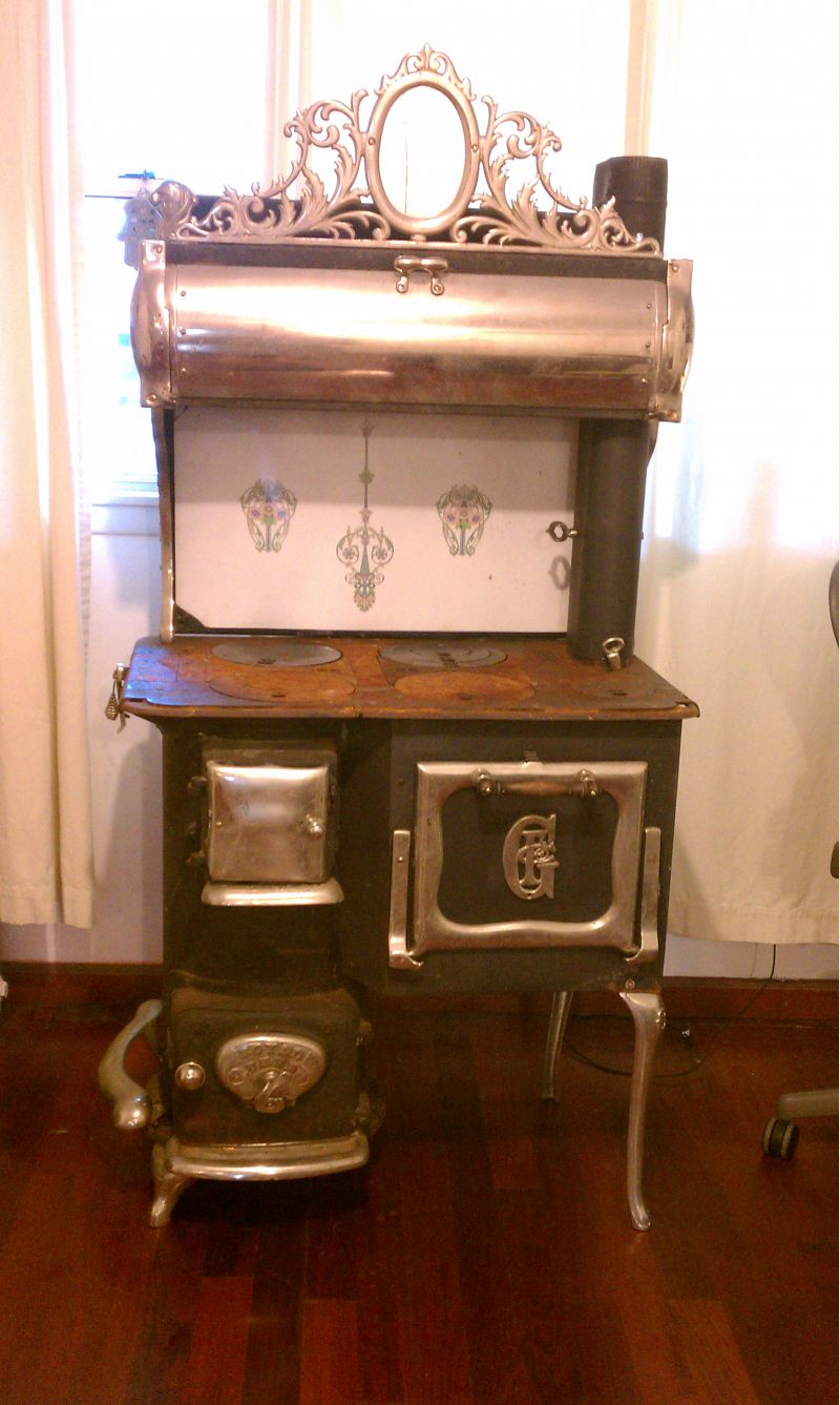

I still don't have a cabin... or land - until next week at least, but I just had to pounce on this. A guy was about to toss it to the scrap grabbers but I got it from him for 100$. It is from 1919 and it is supposed to be in perfect working condition. I will test it later on but he did test it a week ago.
It sat in the rain for a few days so the top has some rust on it and it also has some rust inside.
Anyone knows how to restore it or can give a good link for a guide on how return its glory?

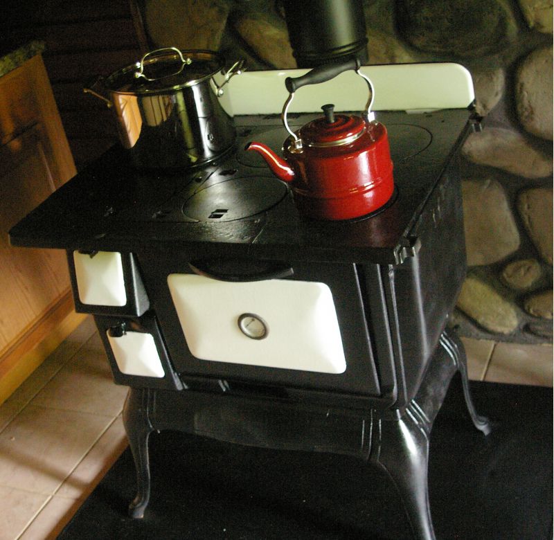

Optimistic nice cookstove! You will love it, these things are amazing! I will never live without one again. We have ours in our kitchen and down to 15deg out with heat our whole house 2700 sqft. As far as cleaning it up, its in great shape just get yourself a tube of williams stove polish (home depot has it around here) and rub it on all your cast iron parts. Do this once a year and you are good to go! After you do it open all windows and get a fire going, it will smoke pretty bad. After the first burn you are good to go. Here is a pic of ours.

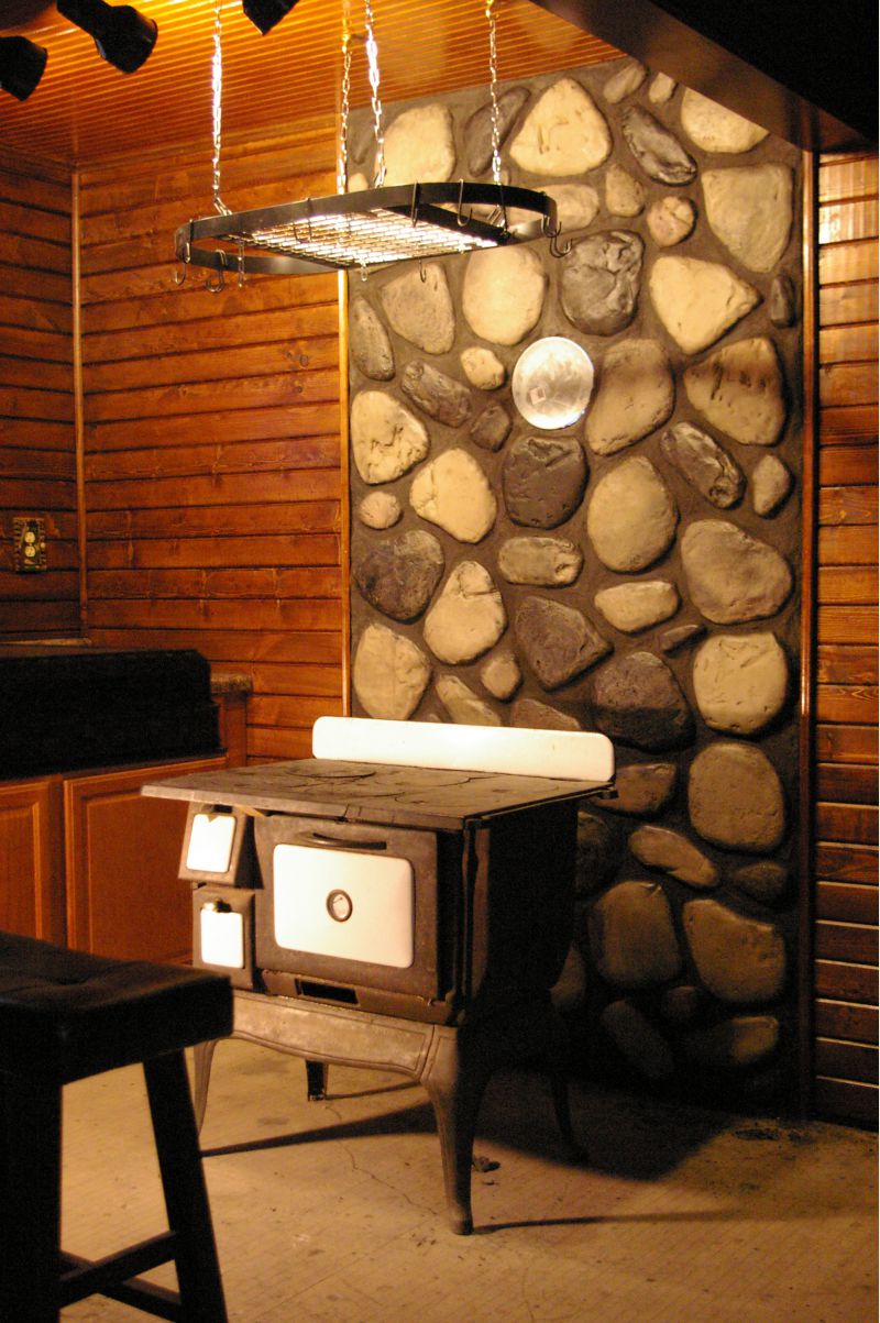

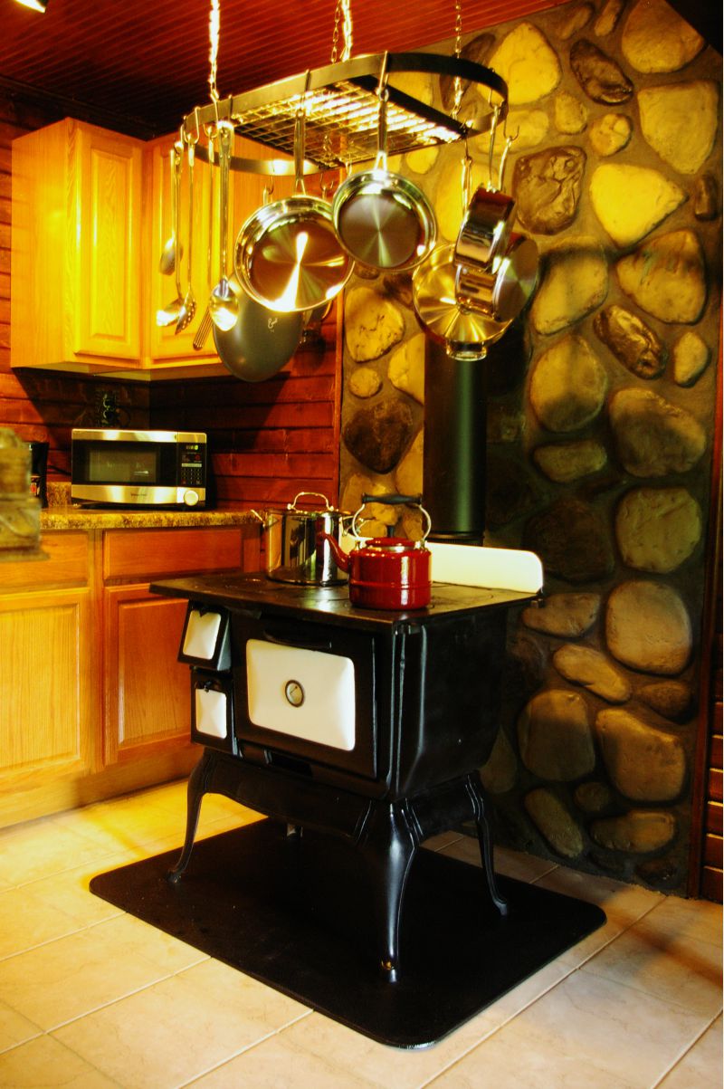

I agree with rayyy. Use a very fine mesh steel wool, wire brush or even course steel wool. Mask and paint with black high temp. Just did the same work on a stove last year and it still looks new.
stove before restoring

restored stove
restored stove
kitchen stove
kitchen stove
