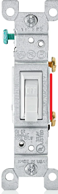

Just wondering if it is OK to use regular household switches on a 12 V system to switch lights. Have 12 Watt LED bulbs so should be one amp passing through the switch. Some places on the interweb say OK others no. Any thoughts.

If the switch says 120VAC only, then no (most switches have this stamped right in).

DC current causes more arcing than AC when disconnection occurs. When used for DC the AC-only switches may wear out faster and might cause contacts to weld together or spark enough to melt plastic parts of the switch. Probably not very likely, but the danger is there. It will be difficult to find a DC-approved switch that will pop into a standard rectangular box.
DC arcs moe than AC because DC current os constantly flowing whereas AC current changes direction 60 times a second. (current flow goes to zero 60 times a second). Makes a big difference but most notable with higher amps.
Then there is always the question of whether or not the structure will be insured. An insurance company may refuse to write a policy or even to pay out on a policy if they question whether or not the electrical was done to code.
