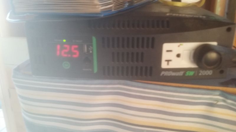

This is my inverter. It was part of an off grid kit I purchased from Grape Solar. Not sure if it's a msw, I will have to check . It's a Xantrex prowatt 2000.
I checked its a pure sine wave inverter.

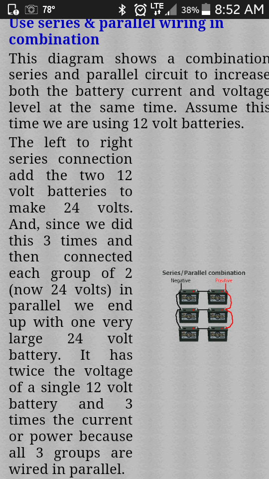

# Posted: 21 Aug 2016 11:53am
Is this the configuration I should use?
Renegaderh
# Posted: 21 Aug 2016 12:27pm
Crossing the negative and positive scares me a lot. Yikes.

I changed the battery configuration and I'm getting 25.1 volts on the charge controller but now the inverter is givung off the over voltage error code.

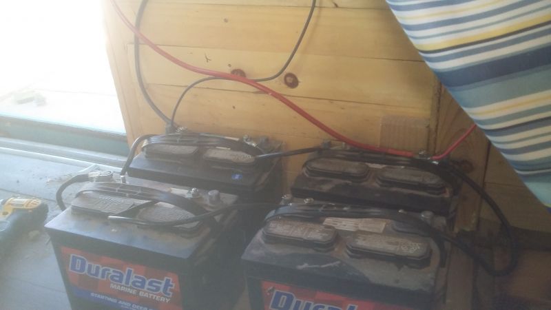

Renegaderh
# Posted: 21 Aug 2016 02:01pm
This is my battery set up. The black and red cables run to the inverter. They look pretty heavy duty.
# Posted: 21 Aug 2016 03:26pm - Edited by: MtnDon
11 = the battery voltage. Too low to operate at the demands being placed on theinverter.
With the battery reconfiguration that gives 25 volts you are lucky tbe inverter is just giving an error message and has not burnt up!
The inverter / battery cables are probably contributing to the problem. Too small, too long. That depends on how many watts you are trying to pull fromthe inverter. A kill-a-watt meter would let you measure actual demand. But if the fridge is a compressor type it will have a start up surge many times the running power.
In order to solve this you need toknowthe total watts being used... then calc tne amps needed to pull out of the batteries for that.
I have the same inverter in a trailer. We use 2/0 gauge cables to reduce voltage drop to be more managable. The alarm still sounds on 1000 draws & that is because the lead acid batteries sag after a short time.
A 24 volt system ismuchbetter but needs a 24volt inverter. Hope you didn't toast yours.

# Posted: 22 Aug 2016 10:49am
You don't need a new inverter. The inverter is fine. I run a 10 cu ft fridge off of a 1200w inverter.
As I pointed out, your inverter is using about 600 plus watts a day. Your fridge. If it's an older Haier. yup. the 1.7 uses 1kw/day. Give or take.
Try putting it in the coolest area you can.
Your battery pack is too small. And possibly too old. Those marine starter/deep cycle batteries don't last long in the situation you are using them in.
Focus on your batteries and wiring. Everything else looks okay.

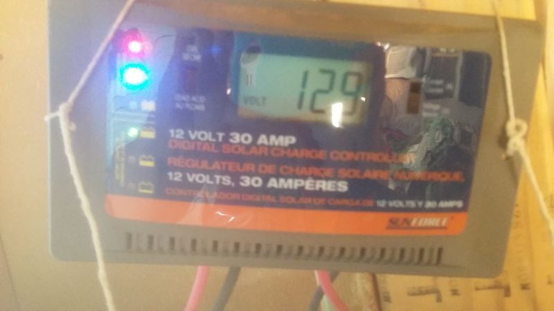

Is your charge controller MPPT? or PWM?
Renegaderh
# Posted: 22 Aug 2016 11:20am
This is my charge controller. Not sure about the mppt or pwm. What kind of batteries do I need and how many?
Renegaderh
# Posted: 22 Aug 2016 11:28am
My inverter is a pure sine wave inverter.

# Posted: 22 Aug 2016 02:51pm
you cc is pwm.
even very tiny fridges can draw a lot of energy. your 1.7 actually uses more energy than my 10. there are some new small fridges that use under 200 kw/yr. look at the energy guide rating.
your inverter is a good inverter. no doubt. yours claims to be .8a/hr. so 250w / day. that's real good.
