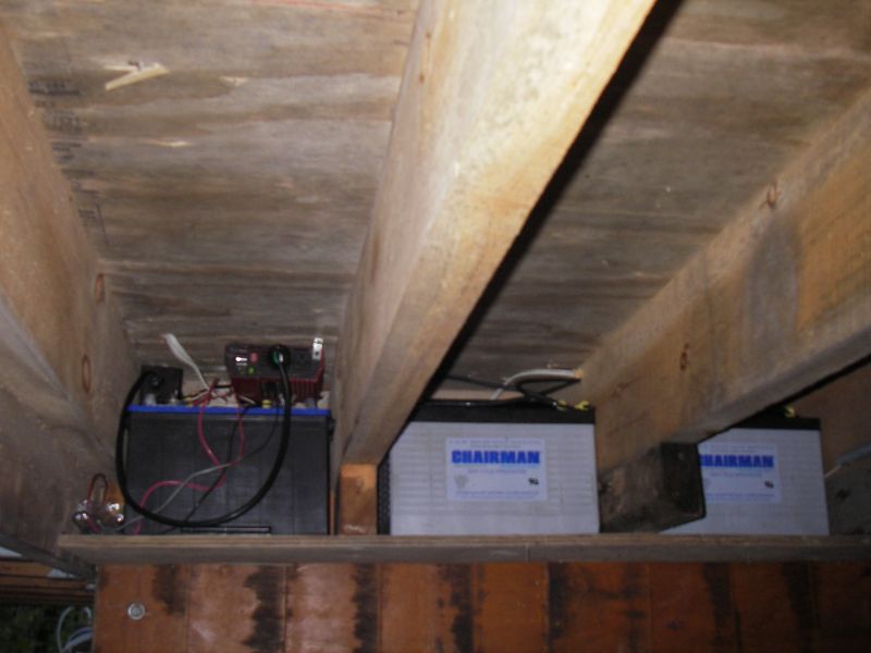

I keep my batteries and inverter under the floor joists of the cabin. I hard wired a switch to the inverter from the inside of the cabin, so I can simply "flip the switch" to turn on power.
Next to the switch, I have two charge controllers and a voltmeter that I wired to the batteries in order to monitor voltage.
Hope that helps.

Vince, I like your idea of running under the floor boards, I had the same idea but the electrician I am working with wasn't too excited about the idea as he said it might start a fire? Is this that dangerous of a setup or should I be OK? I could atleast build a box for it under the floors to contain the batteries and still keep them underneath. Thanks,

You are right about the fire hazard, I've seen batteries "slag" themselves without warning, bith in aircraft and in vehicles, I would NEVER trust them under the floor boards. ever!
