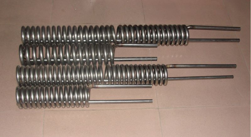

I bought one of these from ChimneyHeaters.com . I installed and it works fine. Heats my 2000 square foot house. I have the pump connected to a UPS but I am not sure how long the pump will run if the electric goes out. I had it installed all winter and did not have to turn on my Electric heat once which saved me about 200 euro a month here in Romania.
The Electric is not stable here so I had to rush to take out the fire a couple of times because the water pump had stopped and the pressure valves were going off. The UPS will solve that but I dont know how long a UPS will keep my central pump going. I will attach a pic of what chimney heaters are in case you are not familiar with them. The pump is a Grundfos and has three speeds.

If some people dont know what a Chimney Heater is here is a pic

That is interesting. Are these used to recover chimney heat, and dump it into water? What do you do with the heated water? I am thinking baseboard or in floor? How does it heat your 2000 sqft? That is what looks to be a small coil,and 2000 sqft is a lot of area to heat. If those are typical 1 sqft tiles that coil cant be more than 9 inches in length ( the formost one, I see the others are longer). What is the diameter of the pipe? 1/2 inch? and what is the diameter of the entire coil?

I imagine baseboard, so this fits inside the chimney? and a pump must have to circulate the water. If thats so I would be very worried about a flow restriction,pump failure, power failure. The design, and application does not look fail safe.

If they are ment to go on the side, why are they round,and not flat, Why the name "Chimney " heaters? Not that I disagree with you as I personaly would not put one in a chimney for the reasons you gave.

the coils i bought back in 84's were "Round as well" better flow---flatten out 1/2" pipe & you restrict the flow. i looked for the paper work can't find it . & i eventually burned out the stove threw it away-it's one with Flip top-Brick lined access right end held 22 "logs--you could cook on it-they (were) about 300.oo at the time-I still see them,in Hard ware stores,@599.oo 6" output on the Back.
