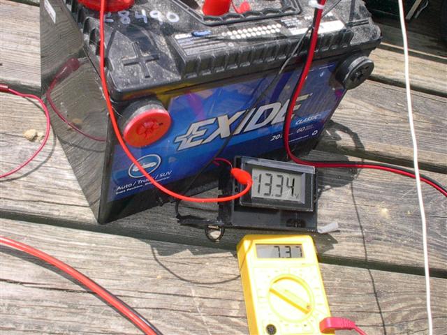

| sparky1 Member
 | # Posted: 15 Jul 2012 02:36pm - Edited by: sparky1 Reply
 forgot to add picture of what The panel is doing.
 I am very pleased--yes the Amperage did drop off as it charged the battery. i didn't care what the OPEN circuit voltage was.
 added;the battery "is new" and I had allready charged it-this is after the solar panel was on it after 1/2 hr-I had to find my camera.
| MtnDon Member
 | # Posted: 15 Jul 2012 03:15pm - Edited by: MtnDon Reply
 The Voc only matters when it is higher than what the attached equipment is rated for.
 What voltage did the battery reach finally?  13.34 is not high enough to provide an adequate charge in any reasonable length of time.  Or was that the float voltage?  Voltage should be up in the 14.4 to 14.8 range when getting a good charge. (based on a 12 VDC system).  My 24 VDC system regularly runs up to 29.6 volts under bright sun.
 Sustainusfarm ... If I could have been connected to the grid for $1200 I'd of done that too instead of spending $8K to have a system that reliably provides all the power we need.  IMO, in most places with a cheap and handy grid that saves money.  What can then be done is to install a good inverter charger and a small set of batteries, along with a generator. The grid keeps the batteries up and ready thru the inverter charger. If the grid drops there would be an auto transfer switch that then supplies power from the batteries, thru the inverter to the cabin. Best is when the wiring in the cabin was installed to permit only the mission critical circuits to be powered up by the inverter... fridge / freeze, maybe furnace blower if any and a light or two. Put an auto start on the generator to have it start up when the batteries get too low. You can go for days/weeks depending on fuel. Use a propane fueled generator and have a large tank kept half full or better at all times.  (I have friends in VA with such systems and they made out fine during the past storm and 9 day power outage.
 Then someday add some PV panels if the power utility offers net metering. Have friends who do that too.
| TomChum Member
 | # Posted: 16 Jul 2012 08:48pm Reply
 Quoting: MtnDon 13.34 is not high enough to provide an adequate charge in any reasonable length of time
 But is it getting 7.37 amps?  13.34v x 7.37A = 98Watts.  It seems to me like it's going to charge the battery if there's 7A going in.
 However, the 98 Watts is a bit less than the 140W advertised.  Was this test performed in full sun at around 12noon, with the panel angled directly at the sun?
