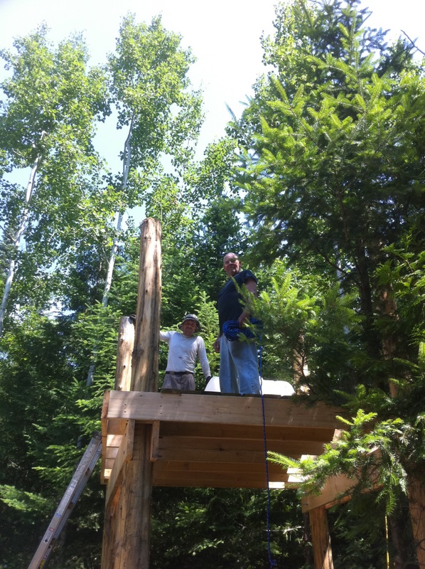

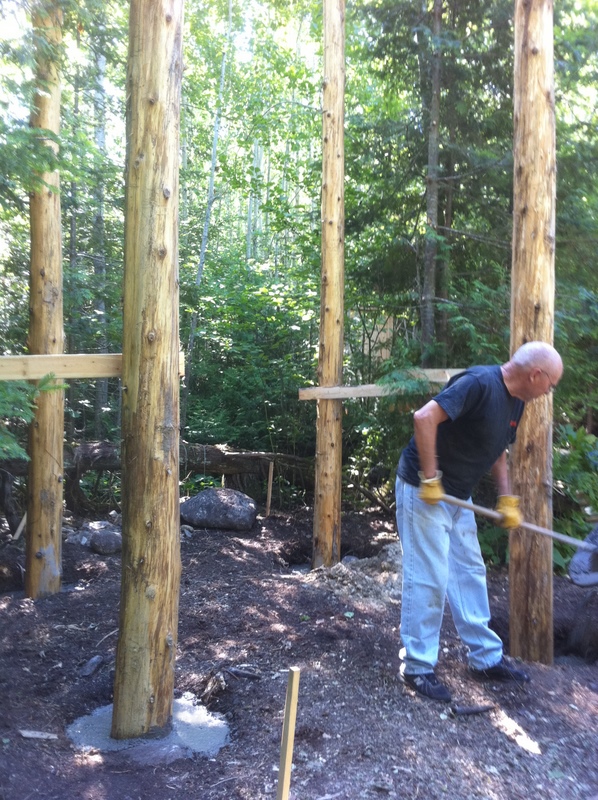

My DH and son built a water tower last year for our off grid cabin. We will finish it this year with some railing,ladder and enclose the bottom for a tool shed.
Posts in place
Posts in place

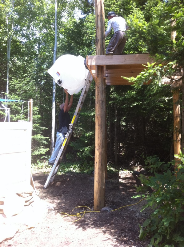

Hoisting the water tank
A job well done
A job well done

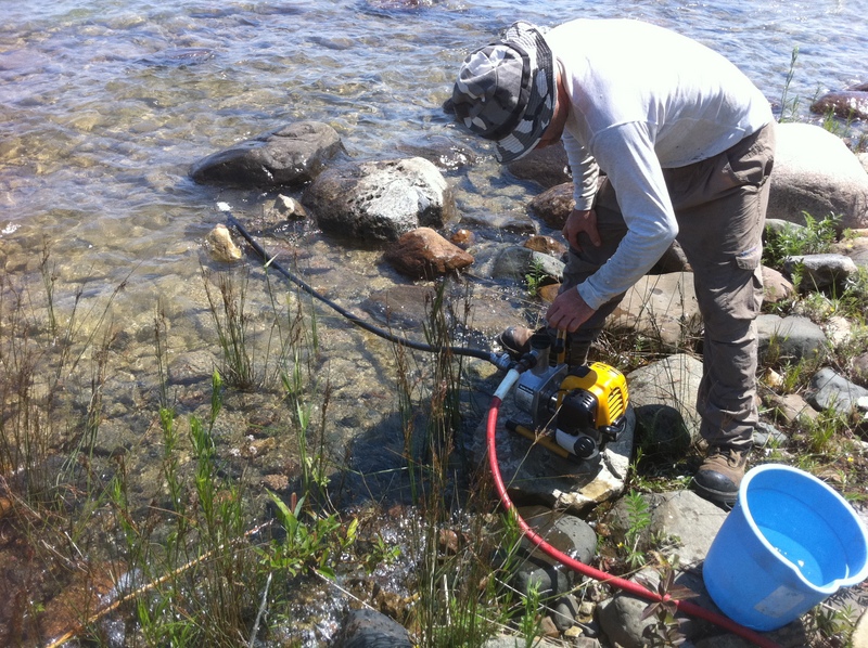

Pumping water from the lake to water tower

Thats gotta be a all day event with that little pump.
At one of our old Hunting camps, we had a tower with a 500 gal tank on it. we would pump to it with a well and pump.
# Posted: 10 Jun 2012 11:16pm
It takes 30 minutes to fill the 250 gallon water tank.
# Posted: 10 Jun 2012 11:30pm

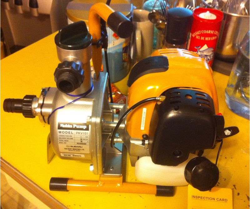

That small pump is rated at 28 gpm. Due to the incline and length of hose we get about 8.5 gpm. Not bad since I needed a water pump that is portable enough for a women with a back problem to carry.
Spudmasher1
# Posted: 29 Aug 2012 05:06am
silverwaterlady what brand pump is that? Is it 2 cycle gas? Thanks Spuds

Spudmasher1 it is a Subaru PKV101

A close shot of our water pump
Gasoline powered water pump
# Posted: 20 Jun 2014 06:25pm
Thanks for the link. As you can see I already have a water pump. His pipes and fittings cost more than I paid for my pump. I cannot use a system like his because of the weather. I like my pump because I can take it home being as portable as it is.

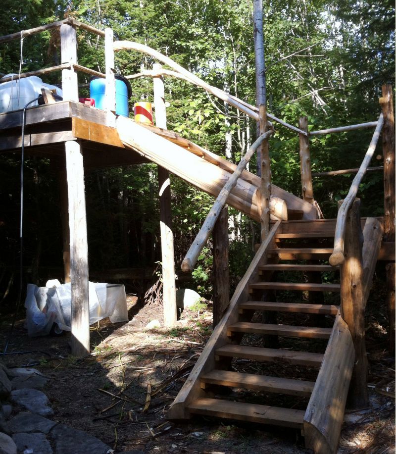

Update on our water tower:
Son has built steps for us. Sure will be a lot easier to get up there and safer. Will post some photos when we return from camp.

How far are you pumping the water?
# Posted: 16 Jul 2015 08:26pm
Hi offgridjunkie,sorry I didn't respond sooner. I just saw your post. We pump it 200' from the lake and 20' up to the tower.

New steps built on a 6" rise making them easy to climb.
