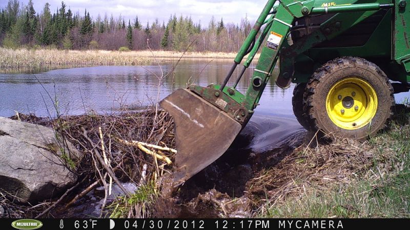

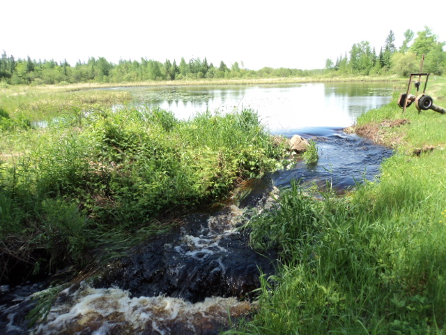

 | # Posted: 12 Jun 2012 03:00pm - Edited by: OwenChristensen Reply
 It gets pretty low in late summer. The beaver are always a pain. I can't let them do their thing in that pond as the road and earthen dam might wash out. Here's how I wreck it.
 Owen

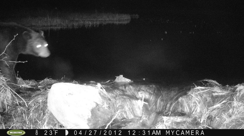

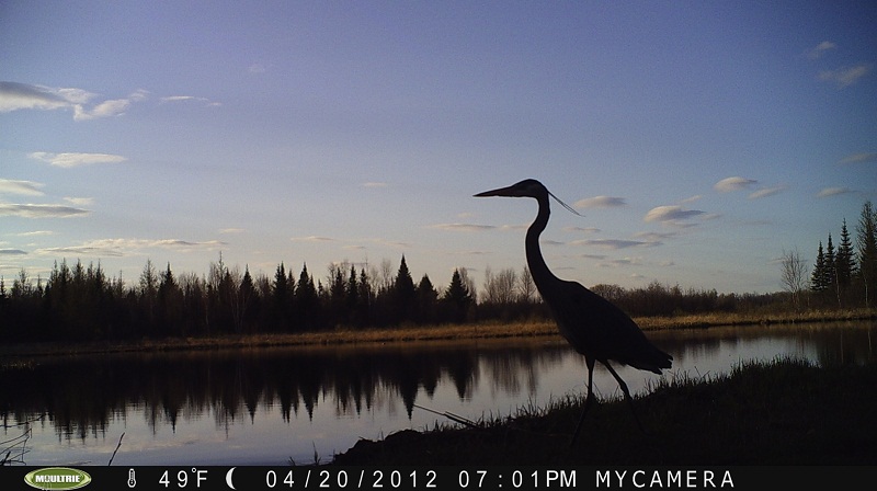

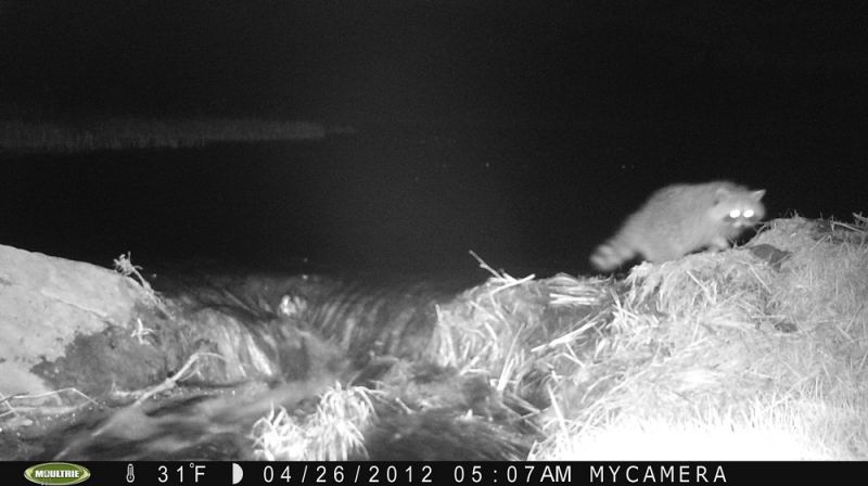

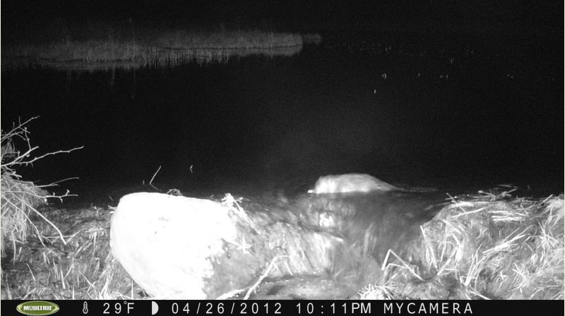

 | # Posted: 13 Jun 2012 05:10pm Reply
 I love that cartoon......Angry Beavers!
 I do try a get pictures on game cams of any of that type of action.
 Owen
 |  heron at beaver dam
 |  beaver
 |  bear at dam
 |  racoon at dam
