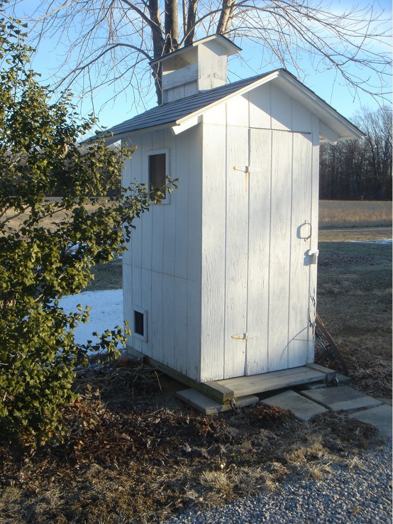

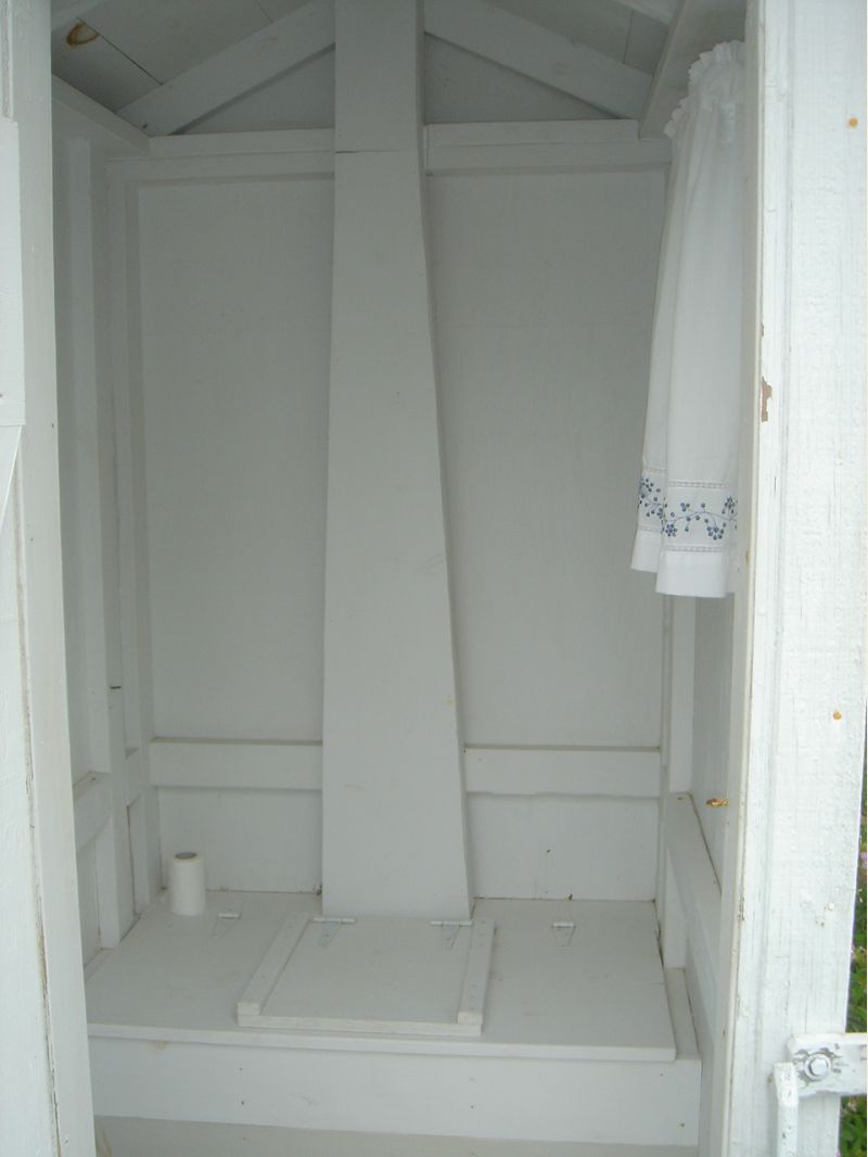

 I also have a built in vent that come up to the top of the rear wall but it does not work well. The outhouse I have that is the Pail Privy type does have a vent to a copula type top portion which seems to work better and although difficult to build does create a better draft. Plus with the pail set up it draws air in on both sides at the bottom of the area under the seat. I will put up another photo of that set up for those who have not see it, its from an old government sanitary privy literature.
