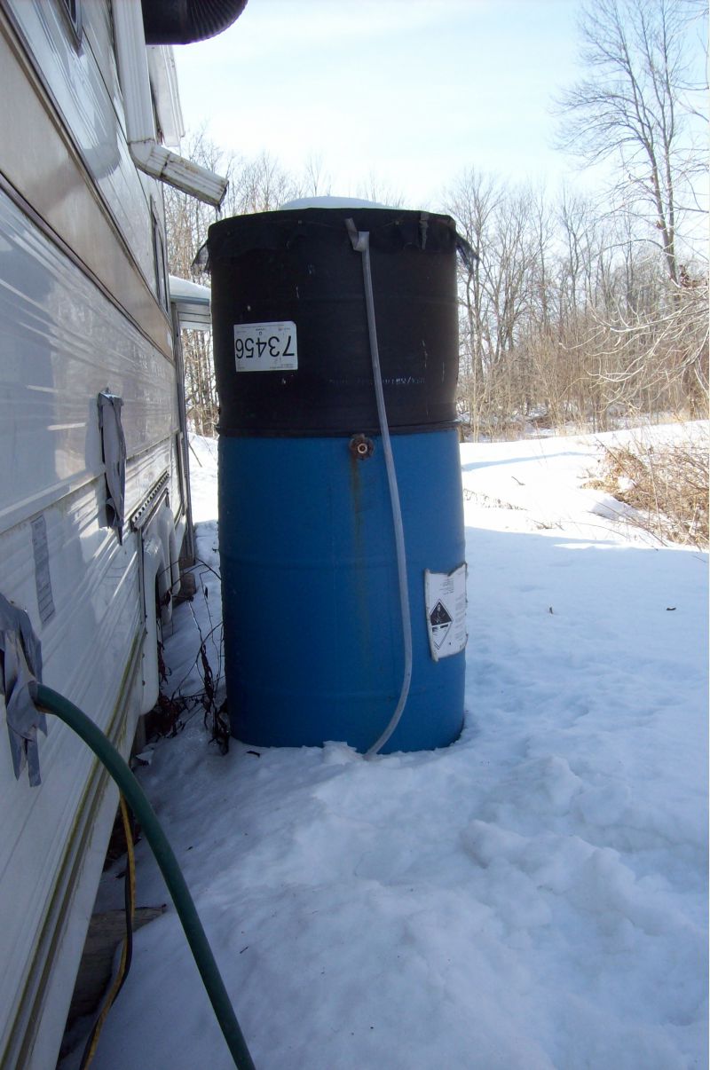

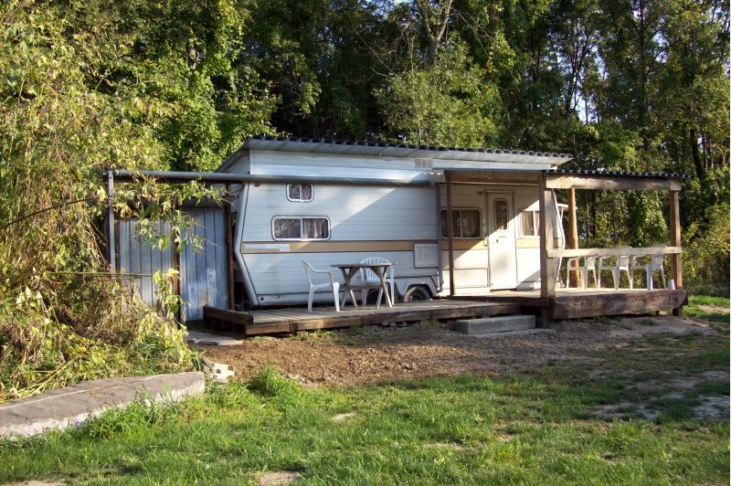

i have a old trailer setup somthing like you want.1975 trailer i payed 250.00 $ it came with both 12volt and 110 wiring . it also came with a 12 volt water system that we huked to a 45 galon rain water tank with a sand filter . we get our power from a 30 watt solar panel with 2 ,140 amp deep cell bateries [will last a three day weekend if u are carfull] . no fridge but lots of cfl's and led lights fans tv and radio small microwave oven .1000 wat inverter to make the 110 volt power. the trailer has a propane stove oven combo + hot water heater but we never use the hot water heater [it dose not need any electricity] it has a double sink and a out door shower . we removed the indoor bath and built a outhouse as a septic was'ent in the budgit. would like to have a underground cold celer someday. we installed a wood stove in the space the bath was in. we have lots of fun at this little spot good luck with yours
24 FT SLEEPS 6
24 FT SLEEPS 6
RAIN WATER
RAIN WATER

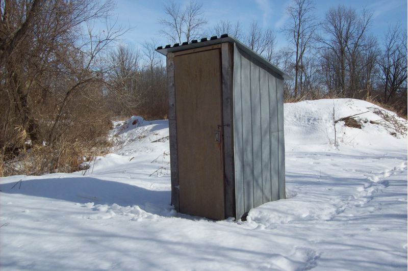

OUT HOUSE
OUT HOUSE

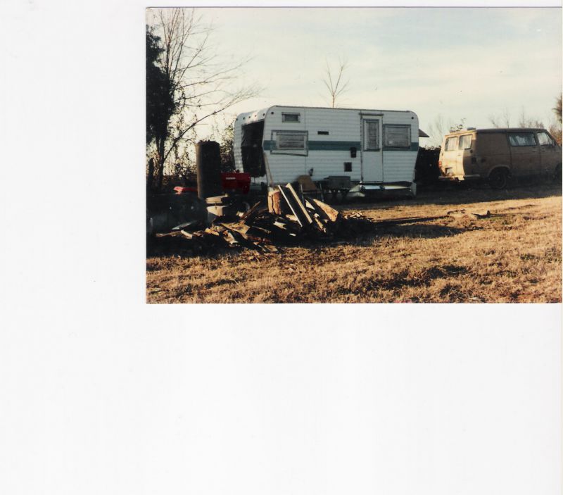

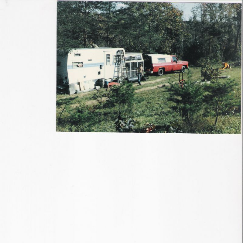

I started out in a 17 ft Travel, trailer in 84 no power any where close, in the field,old "Gas" water heater on blocks for hot water,,gravity flow to the camper.13oo watt Generator to charge batteries,and put water in the water heater,from 5 gallon containers did this a year .till I moved to a lower part of the property.
then i got some old storm windown and the camper shell made a shower roon & water storage
starting out 1984
starting out 1984
1985..86 before septic in 86

JUst...im in a pine forest. You can imagine how much pollen from the trees I get into my rainbarrel....will the sand filter take out the pollen? Do you add your chlorine to the top or bottom of your rain barrel? Looks like your tube goes down to the bottom of the barrel??

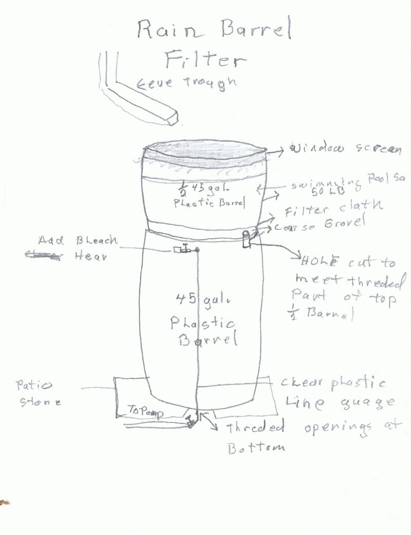

yes the filter will take out anything bigger than a germ for that we use
chlorine once a week plus we boil all drinking water. i have a drawing of the water filters iner parts i will repost it here, if i can find it..optimistic[/b]
yes the water would freeze but we drain it after hunting season till about march we fill the lines with anti freeze and have a drain with no trap under the sink so we can use the sink with bottaled water all winter..you could keep water all winter in a underground tank with a submersable pump..there are lots of good threads on this site about solar set ups, i learned all i know here.just ask if you need help when you get started!!thanks for the compliments but this is just a basic system no frills so i could have a place with very little cost.less than a 1000$

here you go
sand filter
sand filter
