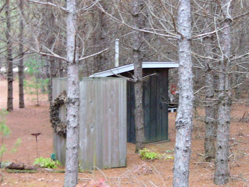

Mine has a plastic vault as well...I have it pumped ever 2-5 yrs...I have been doing it this way since the outhouse was built in 1995...works great! I used plans for an outhouse in a book called Cottage Water Systems...I think the venting plan I followed in the book has worked out great... The outy and the shower
