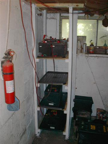

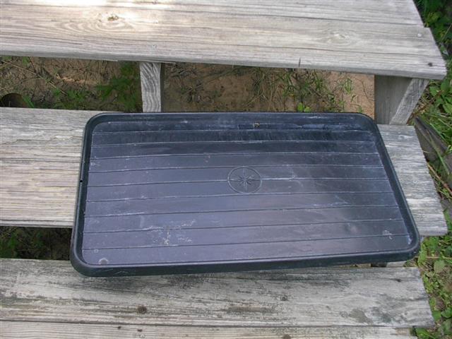

I built a very sturdy Wood rack for my (3) 4D battery's they each sit in a acid resistant tray (granger) incase a possible boil over, fresh water and baking soda on site as well as paper towels rubber gloves,Getting a face shield this week. the (4) group 27 battery's top shelf,same system of things. in my basement free from extreme temps.I did buy 12 volt Battery Blankets for them "if the temp drops below 40 degrees..i live in southern VA.coldest ever here was minus 6 degrees.
Battery rack-solar system.
battery tray
battery tray
