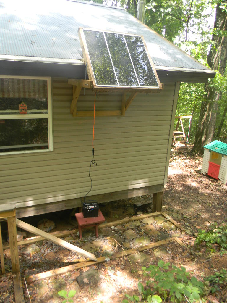

# Posted: 29 Jul 2012 08:23am - Edited by: SE Ohio
  I used pressure treated wood to make a tilt-able solar mount that bolts to the cabin.  The angle adjusts (manually) up and down for the sun angle/season.  Short DC run to charge controller and cabin.
  Panels/controller are from Harbor Freight.  45W is enough to charge deep cycle battery for my lights/stereo.
  Picture shows battery charging outdoors to keep outgassing outdoors.  Might change to indoor setup with vent tube in future.
