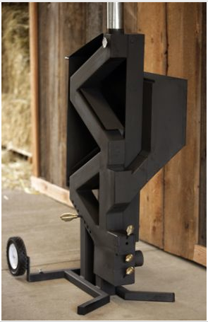

TomChum
# Posted: 30 May 2012 01:56pm - Edited by: TomChum
There are pellet stoves that operate by gravity. $1100-$1400
http://clarrypelletstove.com/pages/theroosevelt.html
Search on Google for "gravity feed pellet stove", there are lots of people building auto-feeders to feed a 'normal' stove. I suspect it might make some noise each time it does its 'feeding cycle'.
There is a YOUTUBE video showing how it works. The pellets come down a chute, eventually blocking itself. When that pile burns away then more pellets slide down, again plugging the chute, and stopping. And the cycle goes on.
A gravity feed pellet stove on Craigslist for ~$1200
