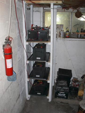

# Posted: 15 Aug 2012 08:02am
Depending on how your set up-& power going into them. I have (3) of them in a rack---lots of power-I charge (1) at a Time & use (1) @ a time. my 2 cents.
